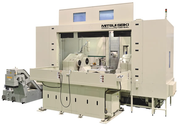

Courtesy of Mitsui Seiki USA
A custom 1,900mm-dia. pallet for a helicopter rotor hub component is produced in a Mitsui Seiki Model HU100-5XL 2m trunnion machine.

Speculating during a lull in business last year that there would be a demand for them, Mitsui Seiki USA built eight 5-axis, fixed-spindle, trunnion-style machines in 6 months without having purchase orders and sold all of them to aerospace part manufacturers. “It was a good gamble,” Walker said.
The trunnion machines include three models: HU100-5X with a maximum part swing of 1,500mm (59 “) and a maximum part height of 1,050mm (41 “), HU100-5XL with a maximum part swing of 2,000mm (78 “) and a maximum part height of 1,200mm (47 “) and HU100-5XLL with a maximum part swing of 2,500mm (98 “) and a maximum part height of 1,200mm (47 “).

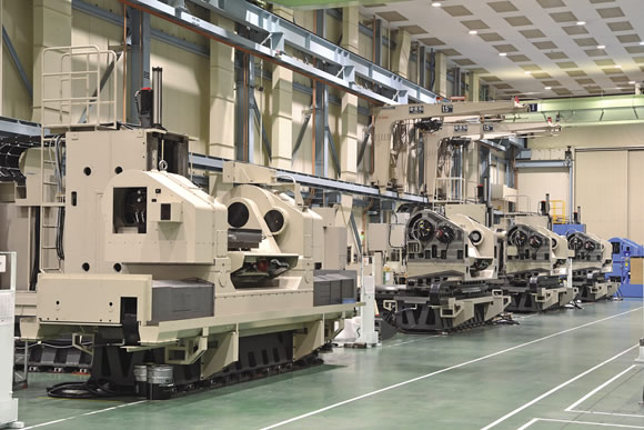

Four of the eight large 5-axis, fixed-spindle, trunnion-style machines Mitsui Seiki USA built in the last half of 2012 in anticipation of market demand.

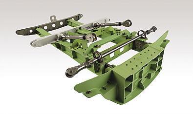

Exacta Aerospace is one manufacturer of aerospace structural parts that is machining more monolithic designs. The Wichita, Kan., company produces many parts made of Ti6Al4V and heat-treated 138 stainless steel, as well as a bit of Inconel, for practically all of the aircraft OEMs, noted Kelly Eilerts, 4/5-axis supervisor. Rather than complexity, the size of monolithic parts is more of an issue for Exacta, which recently purchased a Mazak 5-axis Vortex 1400V/160 II vertical machining center with two rotating axes in the spindle head and an X-axis travel of about 65 ” to accommodate the parts being machined and the ones on the horizon.
“We purchased it so we could get bigger titanium parts because there are quite a few out there,” Eilerts said. Other machines at Exacta include 4-axis a81M and a82M horizontal machining centers from Makino, which have 8,000-rpm spindles that produce 740 ft.-lbs. of torque and are arranged in a work cell to machine titanium parts up to nearly 40 ” long.
Courtesy of Exacta Aerospace
An assembly Exacta manufactures has two titanium details that measure about 3 ‘ in length: one is painted white toward the middle of the assembly and the other is at the back and painted dark green.

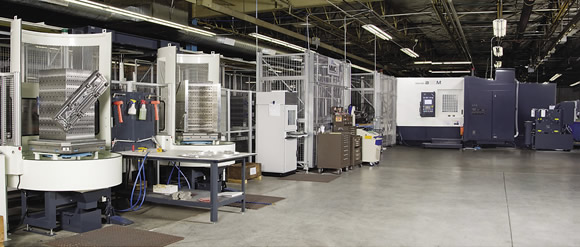

Exacta Aerospace’s a81M/a82M hard metal Makino Machining Complex produces titanium parts up to 40″ long.

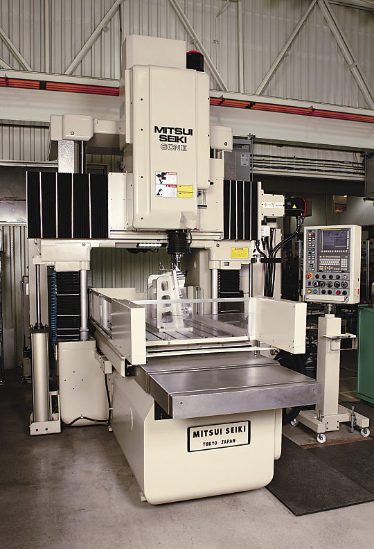

Mitsui Seiki USA refurbishes jig borers, such as this Model 6CNII.
