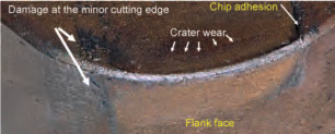

He added that flank wear, which occurs at the flank face of the minor cutting edge, is followed by crater wear, which predominantly forms on the rake face near the major cutting edge, and edge chipping, which can lead to catastrophic tool failure. To improve the productivity and reliability of hard turning with PCBN tools, impart finer surface finishes and protect the cutting edge—especially around the insert nose—an optimal edge preparation is required.

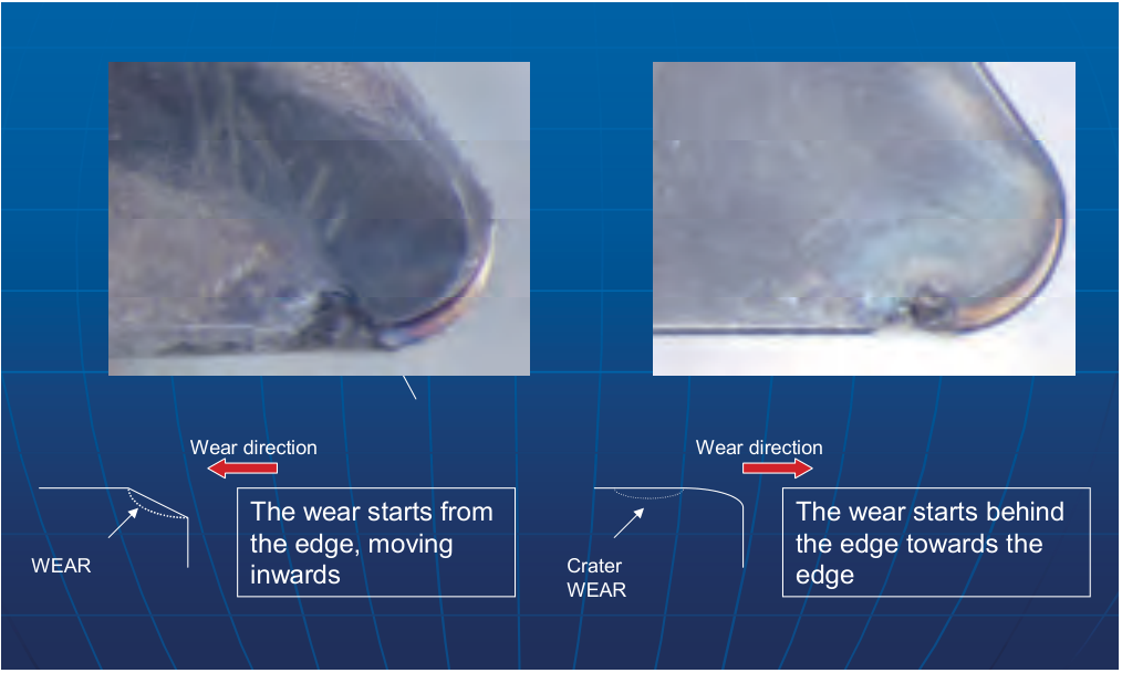

Cutting tests conducted by Conicity Technologies show tool wear and its direction on PCBN DNGW 150608 inserts with a standard T-land edge preparation (upper left) and Conicity’s waterfall edge preparation (upper right). In addition, the T-land insert produced unstable chip chips (lower left) and the waterfall insert created stable chips (lower right).

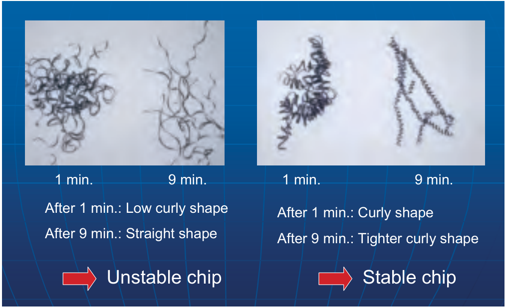

Unlike a T-land, which causes wear to begin at the cutting edge and move toward the center of the tool, a waterfall, or oval, corner profile having a variable edge preparation causes the wear to begin away from the cutting edge and move toward the edge, Shaffer explained. “This delays the distortion of the cutting edge and allows a higher level of chip control,” he said, adding that chips hug the top of an insert with a waterfall hone and effectively exit the cutting zone.
In contrast, chips get pinched between the tool and workpiece and exit vertically with a T-land tool. “There is no real exit avenue for chips with this edge geometry,” Shaffer said.
Compared to a standard radial hone that keeps cutting forces isolated on the tool tangency, the oval geometric profile directs cutting forces off the tangency and deeper into the tool, which reduces tool pressure, according to Shaffer. In tests and hard turning applications, waterfall edge geometry reduced tool pressure as much as 40 percent, he reported.

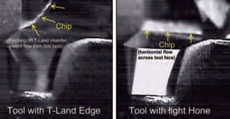

Still images from a high-speed video illustrate the chip flow difference between a tool with a T-land edge and one with a light hone.

Plunge cutting is the most common machining operation for valve seat inserts. That generates varying chip thicknesses and loads throughout the cut and tends to promote chipping or notching of the cutting edge, so a lot of the R&D group’s work focuses on the cutting edge, Christopherson pointed out. Although a T-land pushes material and increases cutting forces, it may be necessary for edge strength. Whether or not a T-land chamfer is used, an engineered edge break transition is important to eliminate a weak “dead sharp” condition, he explained.
Even with a rigid setup, however, the high cutting forces from driving chips into the T-land face generate small vibrations, which can be seen with the company’s high-speed video system. (To view samples of Federal-Mogul’s high-speed videos, click here.)

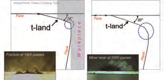

Changing an insert’s T-land angle and flank transition profile made the difference between success and failure.
“We’ve shown a 900Hz microvibration with a ¾ “-dia. boring bar in a very rigid CNC machining center when running a T-land,” Christopherson said. “When we run a simple hone and get the chip to flow smoothly across the face of the tool instead of pinching, it’s a nice, quiet, steady, no-vibration condition.”
