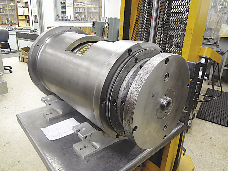

Courtesy of Precision Spindle Service
A machine spindle before being repaired (top) and after Precision Spindle Service repaired it.

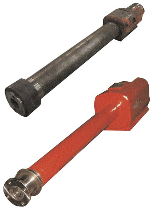

Courtesy of Riten Industries
A before (top) and after photo of an ID grinding spindle repaired at Riten Industries.

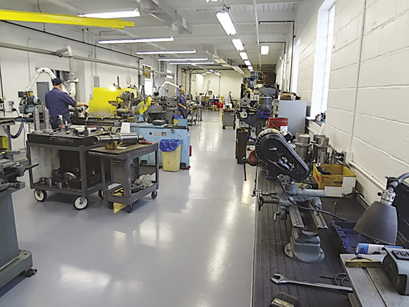

Precision Spindle Service’s grinding and machining department reconditions spindle components during the rebuild process.

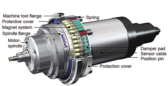

Courtesy of Jakob Antriebstechnik
The mechanical components of the Jakob motor spindle safety system enable the controlled and reversible decoupling of the main spindle from the machine structure when a collision occurs.
Spindle safety system for crash landings
A machine tool crash, especially one during a rapid movement at 60 m/min. or faster, can damage a spindle, requiring costly repair. During most crashes, manually activating the emergency stop is too slow to prevent damage. Even with proactive crash avoidance via CAD/CAM programming and reactive damage reduction methods, such as electronic sensors and mechanical overload clutches, crashes still occur.
To protect a spindle from collision damage, Jakob Antriebstechnik GmbH, Kleinwallstadt, Germany, introduced the motor spindle safety system (MS3) that immediately disconnects the power transmission at the interface between the machine tool headstock and the motor spindle during a collision. Therefore, the shock-sensitive components in a spindle are protected from the peak impact forces of the crash, according to the company.
In addition, decoupling the spindle from the machine structure reduces machine stiffness, decreasing the collision force. To avoid a loss of machine productivity, this stiffness reduction does not occur until a critical force threshold is exceeded.
Roller bearings are especially susceptible to damage during crashes. Because of the small contact areas between the inner and outer raceways and the rolling element, the maximum allowed contact pressure can be exceeded during collisions. This leads to plastic deformation in the contact area between the rings and rolling elements (brinelling), as well as destruction of the rolling elements.
The MS3 also protects shafts, clamping systems, the transmitter and the rotary feed.
The system’s double-flange design incorporates integrated magnets to provide high retention forces and stiffness, the company added. In addition to absorbing spindle shock, the spring and damper elements automatically reset the flange system.
When the sensors of the safety system detect a collision, the CNC immediately stops all axis movements. Immediately afterwards, the machine moves backwards on a return path based on the stored NC program. Then the machine stops at an emergency halt and waits for an operator to check for any damage to the cutting tool, spindle and workpiece. Only after the operator has performed the checks and clearance is manually provided does the control allow the machine to resume cutting or repeat the original machining operation.
