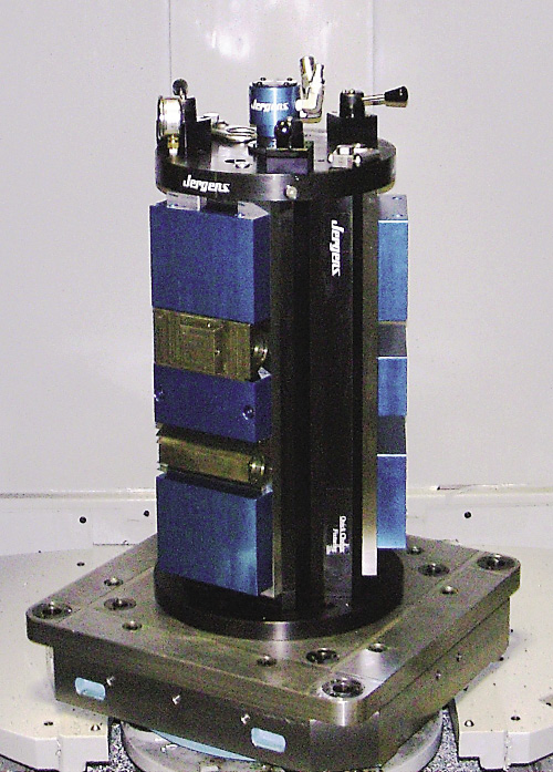

Courtesy of Jergens
A Jergens three-sided tooling column, equipped with hydraulic twin vises, is mounted on a Ball Lock pallet.
Antos explained that vises can be plumbed to clamp and unclamp individually or all at once, depending on how the valves are installed. Better yet, even the simple act of pushing a button can be avoided with a little electrical work and the right plumbing—wiring hydraulic valves into a CNC is a straightforward exercise, one that enables automated clamping and robotic part handling.

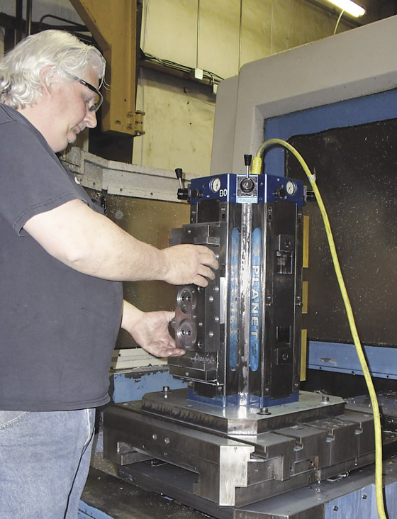

Courtesy of Planet Products
An operator loads workpieces on Planet Products’ production floor. The yellow cord is a removable 25v DC power supply for the integral pump unit. Hydraulic pressure is maintained via an internal accumulator.
In the electric vs. air debate, Dexter said: “Air-driven pumps are easier to install. You don’t need electrical power. They also self-limit—they go up to a certain pressure and stop, whereas electric pumps need a pressure switch to tell them when to stop pumping. But, for some applications, we’ll utilize an electric pump with a high-rpm motor and very fine pump adjustment. This gives high pressure without the risk of slamming the vise shut.”

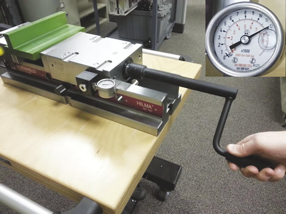

Pump size and type ultimately come down to the pressure and volume required for an application. Yet David Vilcek, engineering project manager for Carr Lane Roemheld Manufacturing Co., Fenton, Mo., might tell you to ditch all those pumps and lines and select its hydra-mechanical vises, which offer the benefits of hydraulic workholding without the plumbing.
“Hydra-mechanical vises utilize a self-contained hydraulic system,” Vilcek said. “Like a mechanical vise, you turn a crank until the movable jaw touches the part.” Once it touches the part, however, the similarities change—hydra-mechanical vises have a small detent on the side of the vise. “It just takes a little pop with your hand to engage. When you turn the crank, it advances an internal piston that builds hydraulic pressure, resulting in a very high clamping force of up to 12,000 lbs. on our 160mm vise.”
This isn’t a one-trick pony for the company. Like its competitors, Carr Lane Roemheld also offers externally powered hydraulic vises. Regardless of the brand, it’s important to select the same qualities in a hydraulic vise as a mechanical one. “One key feature is the vise base itself,” Vilcek said. “Those machined out of steel rather than cast iron are more robust. Look for precision-ground guide ways and locating surfaces, casehardened to several millimeters deep.”
Vilcek considers hydraulic workholding a flexible tool for fixturing—not just some “plain old vise”—and a good intermediate step between pure mechanical systems and dedicated fixtures. Hydraulic workholders quickly adjust to part sizes from ½” (12.7mm) or smaller to 10″ (254mm) or more across, he added. “With delicate parts, you can dial the pressure down for a gentle touch. When you need to rip, crank it up. Either way, you’re sure to get the same clamping force every time.”

Courtesy of Carr Lane Roemheld Manufacturing
Hydra-mechanical vises from Carr Lane Roemheld offer the hydraulic advantages of precision and high clamping force but with no pumps or retrofitting, according to the company. This NC device can be operated with one hand, with internal hydraulics generating 12,000 lbs. of clamping force on the 160mm model.

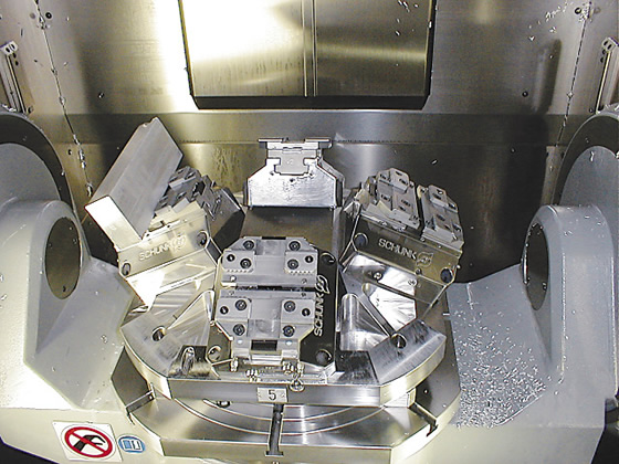

Courtesy of Schunk
Four Schunk KSH 6″ hydraulic vises on a pyramidal fixture base, mounted on a 5-axis mill, permits machining four parts in one setup.
“Shops aiming at maximum productivity will order their vises with quick-change jaws,” Evans said. “They can then mount a number of vises on a zero-point or other quick-change pallet system and plumb the whole thing with hydraulics. Now, when a new job comes along, they can machine the jaws offline, load the pallet into the CNC machine and go. There’s no time lost dialing in the vise or finding the zero point.”

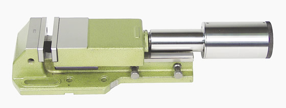

Courtesy of Dapra
Dapra’s HydraVise offers 18,000 lbs. of clamping force with 100-psi shop air.
Big and strong vises
Matt Milhomens, inside technical sales rep for Dapra Corp., Bloomfield, Conn., is the guy to call if you need a vise with a high clamping force. His company’s 8 ” HydraVise has enough to restrain an elephant—100 psi of shop air generates 18,000 lbs. of clamping force.
It works by rotating a spindle on the end of the vise’s movable jaw until it makes contact with the workpiece, then backing the spindle off three clicks counterclockwise, Milhomens said. At that point, you can manually open and close the vise with a valve mounted on the vise or automatically through a solenoid connected to the CNC.
Aside from the benefit of high clamping force, Milhomens said there’s no need for a pump with the HydraVise. “Once clamped, the HydraVise stays closed, even if you lose air pressure.”

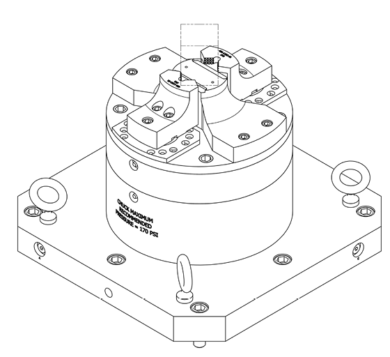

Courtesy of Stace Allen
Mounting a 2-jaw hydraulic chuck on a milling machine is a viable alternative to conventional vises and provides strong gripping force and pullback against a positive stop.
Stace-Allen Chucks Inc. doesn’t make vises. But the Indianapolis-based workholding manufacturer can help you with other types of workholding. Mechanical Engineer and man-of-many-hats Adam Homan said hydraulic 2- and 3-jaw chucks are often good alternatives to vises, given the right workpiece. “One of our customers mills a lot of square aluminum bar stock. We used a 2-jaw chuck with a built-in hydraulic cylinder to grip those parts.”
Because turning and milling departments typically don’t share tooling, rolling a hydraulic chuck from a CNC lathe into the milling department is sort of like inviting a Packers fan to a Bears game. Homan defends this unusual workholding method by pointing out one aspect of lathe chucks that every lathe operator learns early on: pullback.
“In this customer’s case, we wanted to pull the workpiece against a positive stop,” he said. “Hydraulic vises exert force across the sides of the workpiece, but they don’t pull it down and into the locating surface like chucks do. This provides a very secure and accurate grip.”
Homan said the use of hydraulic chucks are on the rise for certain milling applications. “Some of the new 5-axis machining centers have a hydraulic supply that comes up through the middle of the table. It’s very easy to integrate a hydraulic chuck in this case and avoids any exposed hoses.” And because many 5-axis parts are machined in a manner similar to one turned on a CNC lathe—one at a time—using a lathe chuck might make sense, especially when cutting round stock. “Setup is simple. You always know where the center of the part is with a chuck.”
Hydraulic chucks are accurate to a couple tenths, self-contained, consistent as gravity and cost roughly the same as their rectangular counterparts. Maybe it’s time to think outside the box.
