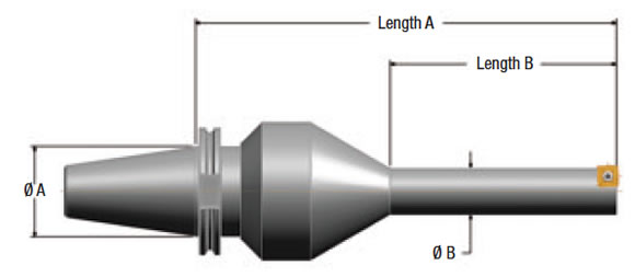

Another overlooked area that influences indexable-insert tool performance in multipurpose machine tools is a tool’s length-to-diameter ratio. When boring, for example, the relationship of the distance from the insert tip to the smallest diameter of the tool body is the length-to-diameter ratio. It is not simply boring depth divided by boring diameter. Many tools may have a diameter smaller than their cutting diameter somewhere along the tool body. This smallest diameter is where the tool will deflect.
For steel tool bodies, anything above a 4:1 ratio can cause trouble, usually in the form of chatter or excessive deflection. Tool bodies made of heavy-metal or Mallory materials can perform well up to a 7:1 ratio, and solid-carbide tool bodies are suitable up to a 12:1 ratio. Similar ratios apply for milling tools with extended-reach adapters.
Figure 1. A tool assembly with two length-to-diameter ratios.
An important tool-performance consideration is the highest length-to-diameter ratio found on the tool. Figure 1 shows two such ratios: length A/diameter A and length B/diameter B.
Consider an example in which length A is 8 ” and diameter A is 1.75 ” (4.57:1), while length B is 4 ” and diameter B is 1.0 ” (4:1). While the diameter B looks small and troublesome, it is actually the gage line diameter that is the limiting factor. A larger connection—say, a CAT 50 instead of CAT 40—would help by reducing the length-to-diameter ratio, thereby adding stiffness to the tool.

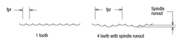

When applying standard inserted tools, surface finish is determined by the corner radius of the insert, lead angle of the tool and feed per revolution. With a single-point tool, surface finish can be accurately calculated. Unfortunately, a multi- point tool produces a rougher surface because of runout caused by the multiple cutting points. Of course, an adjustable tool can reduce runout.
However, the runout of the setting device itself, which generates error, and the runout of the machine spindle will limit how fine a finish can be realized, even with a tool that has been carefully set up (Figure 2).
Figure 2. Runout of the setting device and runout of the machine spindle limit how fine a surface finish can be imparted. The form shown is the finish imparted as the inserts cut across the part, and fpr is the feed per revolution.
It is common practice to use wiper-flatted inserts to improve surface finish when applying tools with multiple cutting edges. With a wiper insert, the insert is usually set 0.001 ” (25µm) above the other inserts so it is the only insert leaving a feed line on the part. To get good results, the feed per revolution must not exceed the length of the wiper flat on the insert.

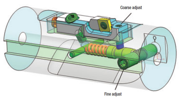

When the position, such as a milled surface, or size of a machined surface is critical, it may be helpful for the cutting tool to have a fine-adjustment feature. When boring, for example, diameter adjustment is required when half of the part tolerance is less than the total possible error in the boring tool. In reality, most manufacturers cut the required part tolerance in half to achieve process capability, commonly called the “capability index” or Cpk.
Figure 3. A coarse-adjustment mechanism and a “clicker” fine-adjustment mechanism used in a line-boring bar to finish bore the crankshaft journals in an engine block.
Fixed-insert pockets in indexable tools can only be expected to be positioned within ±0.001 ” (25µm) of their intended location in the tool body. Total possible error equals pocket tolerance plus the tolerance of the insert’s inscribed circle. When boring, multiply this error by two because the error is on radius and the machine is cutting a diameter. If the total possible error is greater than the required part tolerance, an adjustment is needed.
A simple adjustment, like a radial screw in an ISO-style cartridge, can realistically achieve tolerances of ±0.001 ” (25µm) on diameter. However, a gage or setting device is required to measure the adjustment. Many milling cutters also have some type of adjustment to set insert position.

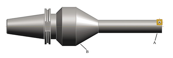

Figure 4. The letters indicate the areas where material is removed when performing two-plane balancing. In single-plane balancing, material would only be removed at point B.
When on-machine adjustment is required or when a tight part tolerance is required, a fine-adjustment mechanism is needed. These mechanisms are available as standard offerings or specials. They can employ fine-pitch screws, cams, tapered wedges or some combination thereof. As an example, these mechanisms can reduce a quarter turn of a wrench from a 50μm (0.002 “) adjustment to a 10μm (0.0004 “) adjustment.
Figure 3 shows a “clicker” fine-adjustment mechanism used in a line-boring bar to finish bore the crankshaft journals in an engine block. One click of the fine-adjust cam equals a 5μm (0.0002 “) adjustment on diameter. No gage is required to make the adjustment. In this case, as the inserts wear beyond what’s acceptable for achieving part tolerance, an adjustment can bring the tool back into size.

It is best to balance a tool as an assembly, such as a cutter and an adapter, and never separate them. This, for example, eliminates the chance of mounting a balanced cutter on an unbalanced adapter. If this is not practical, the next best thing is to balance the adapter by itself, then assemble the cutter and balance the assembly by removing weight from the cutter by drilling holes or milling flats. The advantage is that the adapters and cutters can then be interchanged with little impact on the assembly balance. However, for demanding operations, such as fine bore sizes or milled surfaces, keep the assemblies together at all times to achieve the desired results.
When balancing long tools, it is best to use “two-plane” instead of “single-plane” balancing. This means the tool is balanced as if it were two separate pieces: a front piece and a back piece. Multiple-plane balancing equipment is required to perform this operation. Two-plane balancing helps prevent tool whip, which causes a long tool to cut a larger diameter than intended, when the end of a tool is out of balance (Figure 4).
