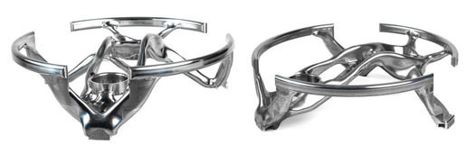

Protolabs worked with the National Aeronautics and Space Administration Goddard Space Flight Center, where NASA generatively designed a hypothetical collection apparatus for the Artemis space mission. Protolabs machined and delivered the 6061 aluminum part in 36 hours. Protolabs

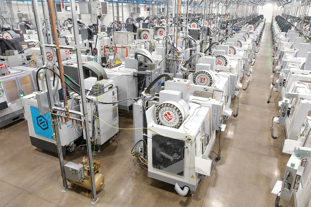

Protolabs’ CNC machining facility in Brooklyn Park, Minnesota. Protolabs
In addition, the manufacturer developed Protolabs Network, with offices in Chicago and Amsterdam. The network of independent manufacturing partners is hand-picked by Protolabs, Marusich said, to outsource work that Protolabs does not have the capabilities to perform at its facility. “We work very closely with them on making certain that they are high quality, and they are able to deliver on time. It’s all available on an e-commerce platform, so our customers come in and it’s fairly transparent to them.”

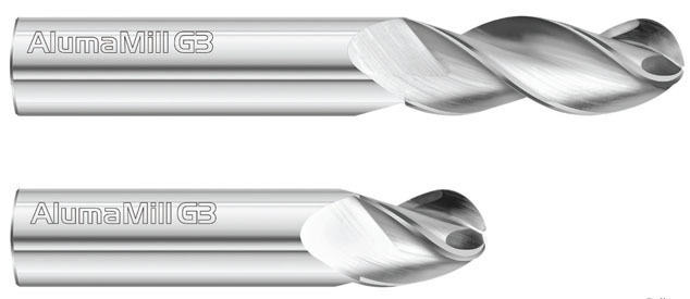

The 3833 AlumaMill G3 is a high-performance endmill with three flutes for roughing, finishing, plunging and ramping aluminum and other nonferrous metals. Fullerton Tool

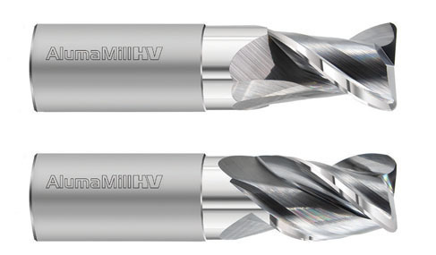

Fullerton Tool’s 3802/3803 AlumaMillHV series is for machining large structural nonferrous components. Fullerton Tool
With a high buy-to-fly ratio and high-velocity machining at spindle speeds up to 30,000 rpm or more for aluminum aerospace parts, a large quantity of chips is created quickly that must be controlled and managed at that rate, said Steve Oszust, product development manager/lead tool design engineer for Fullerton Tool Co. Inc. in Saginaw, Michigan. “You start with a 1,200-or 1,800-lb. billet, and you finish with a 70-or 100-lb. part. There’s a ton of swarf that has to come out.”
To create those chips, the toolmaker produces a variety of cutting tools, with the 3833 AlumaMill G3 being the lead tool in its repertoire, Oszust said. The three-flute endmill is highly polished, has a specialty helix and an engineered rake core, and is suitable for roughing, finishing, plunging and ramping. Fullerton also offers the two-flute 3825 AlumaMill and the three-flute 3835 AlumaMill with a higher rake angle. “The G3, for the most part, is going to be our workhorse unless you’re looking at big structural components. Then it’s the 3802/3803 AlumaMillHV series.”
For ferrous applications, the rake angle is from 6° to 10°, whereas the rake angle for nonferrous applications starts at 10° or 12°, excluding high-silicon aluminum, and goes to 20°, he explained.
