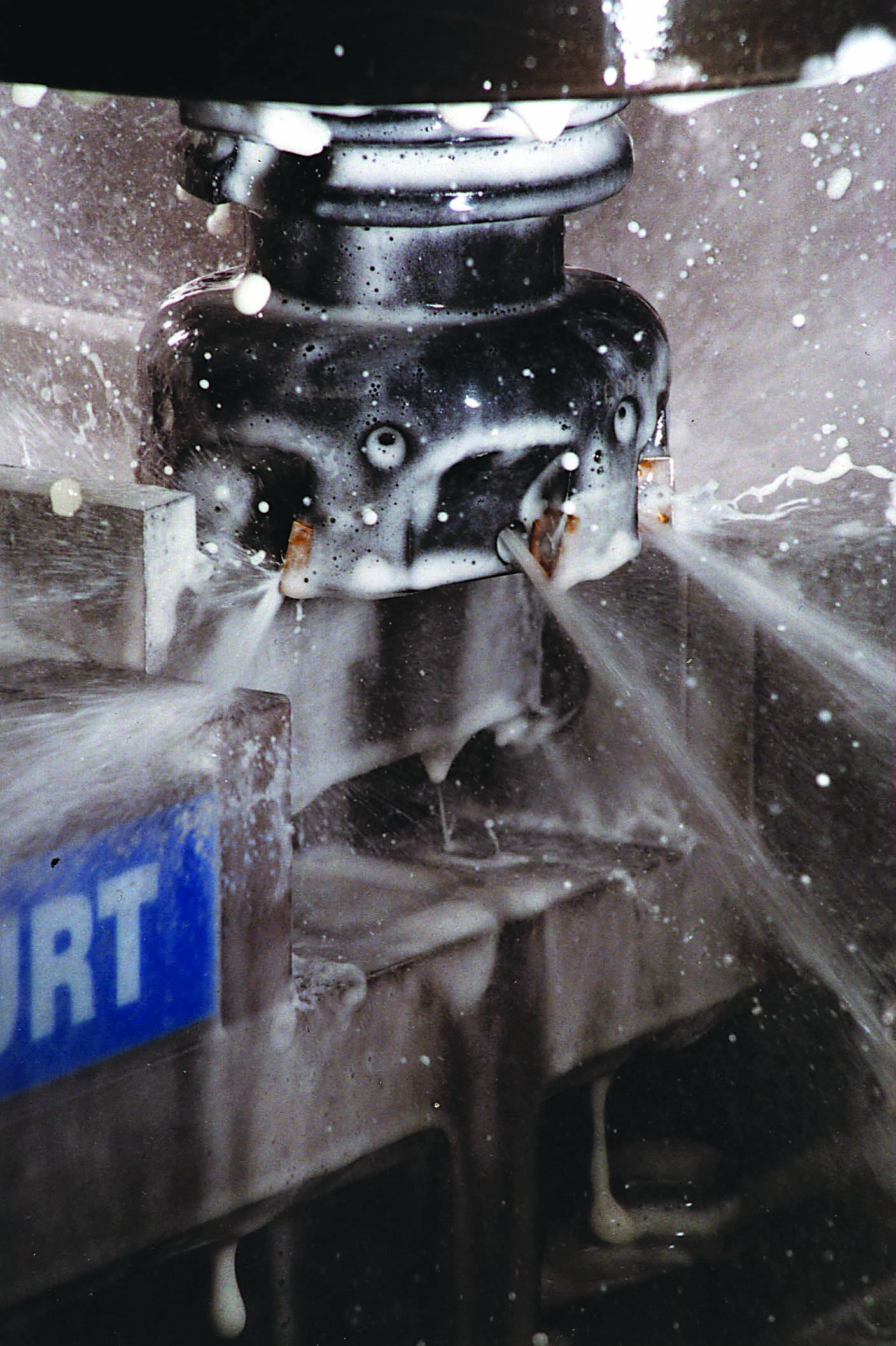

Parker said 1,000 psi (69 bar) is “truly” high-pressure coolant because that pressure is where the amount of force in the coolant stream that hits the part and tool is sufficient to penetrate the vapor barrier, or cushion of steam, that forms as the temperature increases past the point at which water boils (212° F or 100° C).
Breaking through the barrier enables the tool, workpiece and chips to be cooled, Parker said. “For example, 1018 steel chips do not turn blue anymore when you cut because at 1,000 psi the coolant actually pulls all the heat out of the process.”

Breaking through the vapor barrier when applying high-pressure coolant enables the tool, workpiece and chips to be effectively cooled. Image courtes of ChipBlaster.

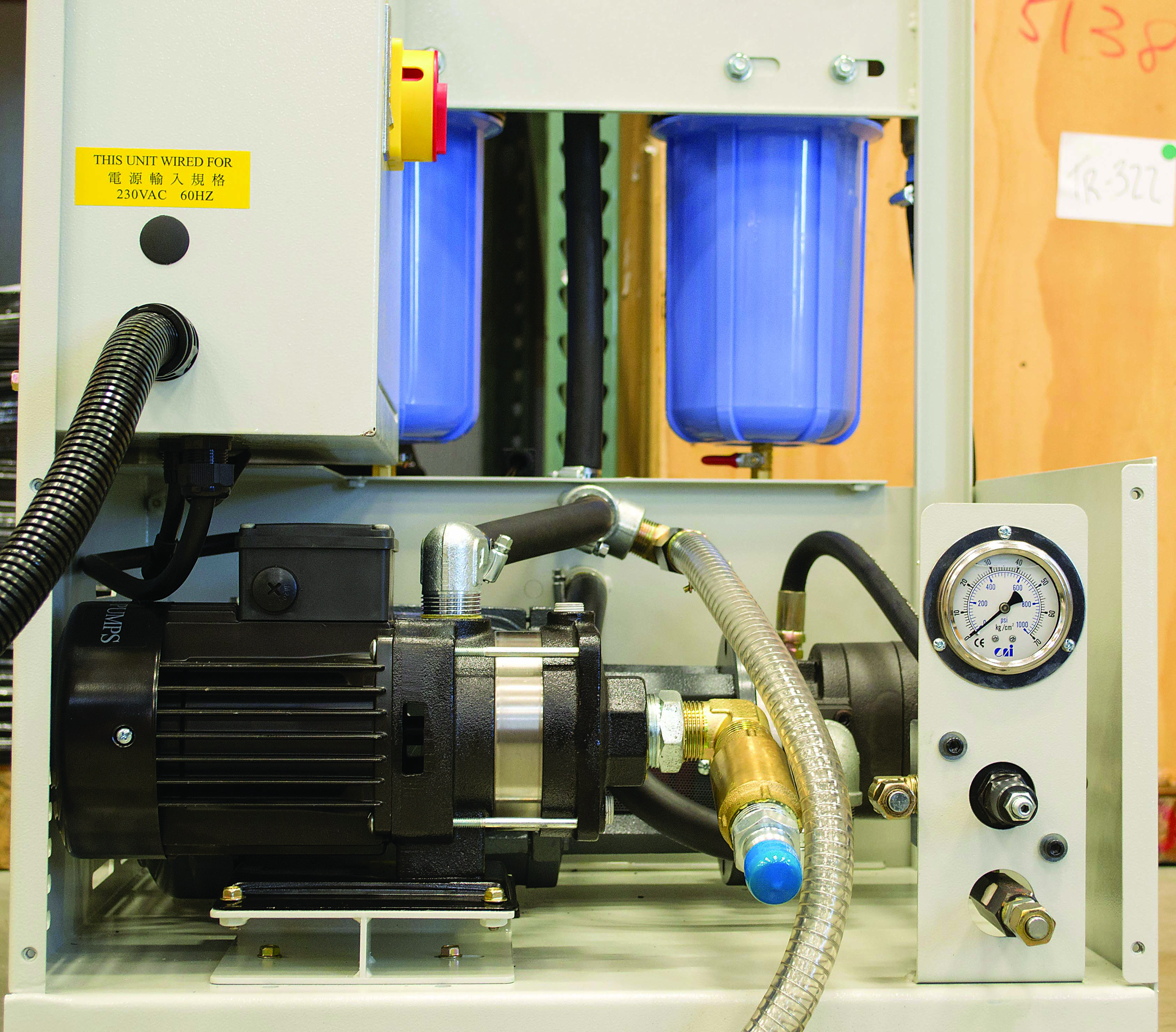

“Although we do not build high-pressure, through-the-spindle coolant systems, we provide positive displacement pumps, which are seal-less, as a main component for these packaged systems,” said John Wanner, senior vice president of operations at Wanner Engineering Inc., Minneapolis.
Because metal fragments from the cutting operation usually infiltrate the coolant, some type of filtration is typically included with packaged systems, Wanner added. Most pumps cannot handle particulates larger than 5µm, so the added expense of fine filtration is required. Otherwise, the life of the pump is significantly reduced.

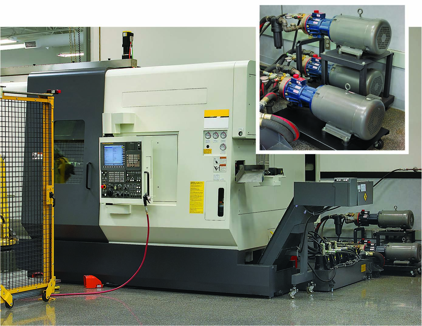

He explained that Wanner Engineering’s Hydra-Cell pumps have hydraulically balanced diaphragms and a horizontal check-valve orientation to handle particulates up to 800µm (0.031″), depending on the model. The seal-less design, which separates the fluid end from the hydraulic end, means that the moving components of the pump do not come into contact with the metal-fines-containing coolant.
According to ChipBlaster’s Parker, a diaphragm-style pump is best-suited for abrasive, heavy-particulate applications, such as when machining cast iron, cast aluminum, ceramics or glass. For more-general machining, such as 1018 steel, he recommends the company’s positive-displacement, piston-style pump. “It gives you a quiet running system with not much vibration and very little pulsations.”
The internal components of the HPC-400 HPCS, which has an 8-gpm gear pump for water-based coolant. Image courtes of CNC Indexing & Feeding Technologies.

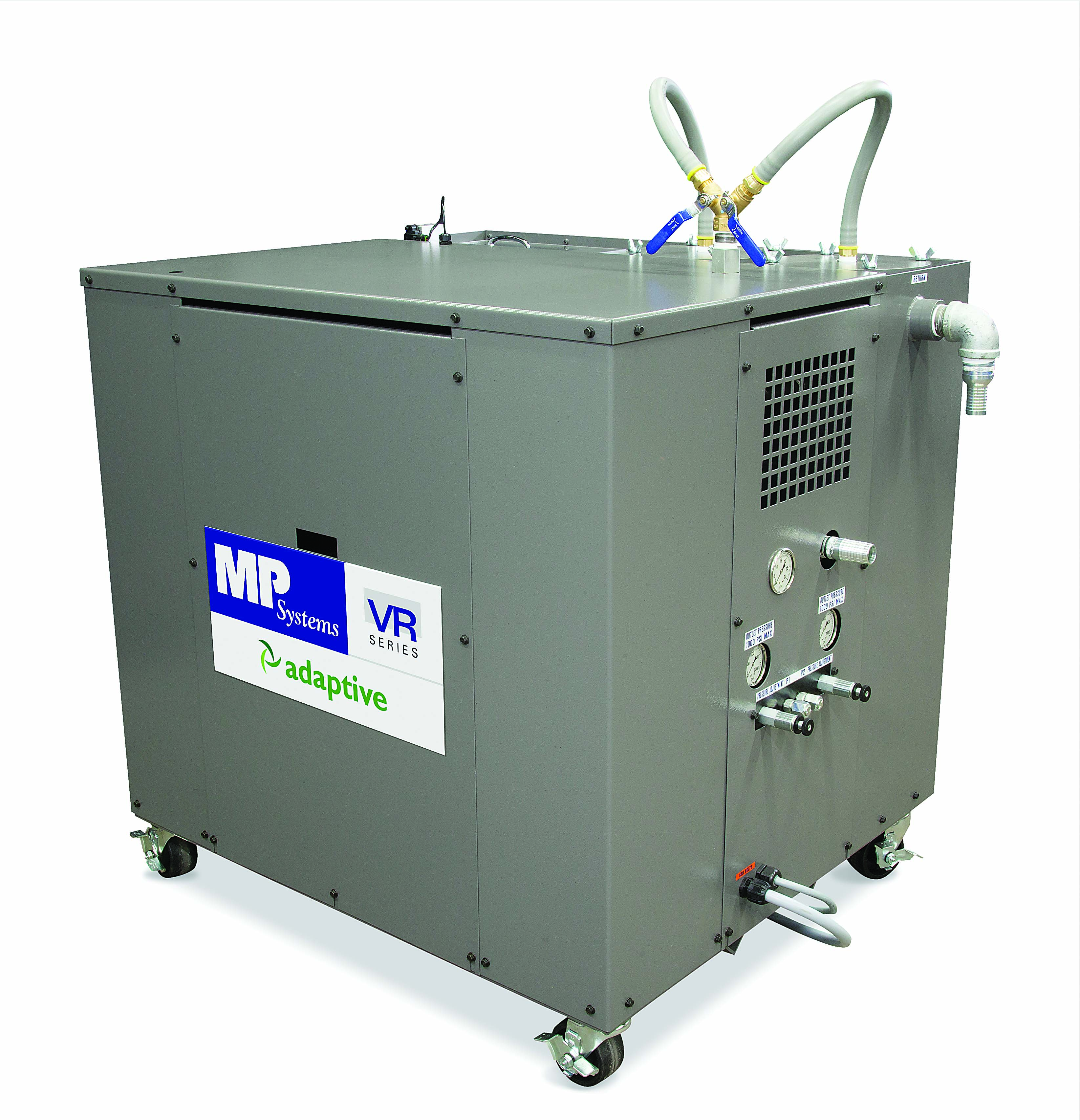

Fortunately, filtration systems are available to remove chips, fines and swarf from coolant. MP Systems Inc., East Granby, Conn., is one HPCS manufacturer that offers coolant systems with a diaphragm pump and filter bags to remove particles down to 5µm, said Kermit Wright, MP Systems sales manager. “We have pumps out there that people have used for 15 years.”
The bags require periodic changing, and some units require annual oil changes, but otherwise the coolant systems are typically maintenance-free, he added. MP Systems’ new Model VR8 variable-volume HPCS, for example, comes with two quick-change, large-capacity filter bags. The VR series also has 50- or 70-gal. (189L or 265L) vertical reservoirs, depending on the model.
This Nakamura machine has a pump package for high-pressure coolant. The machine has three Hydra-Cell pumps (inset), with one pump for each turret. Image courtesy of Wanner Engineering.

The VR series from MP Systems comes with two large-capacity filter bags and a machine installation kit and can be used with water- or oil-based coolants. Image courtesy of MP Systems.
