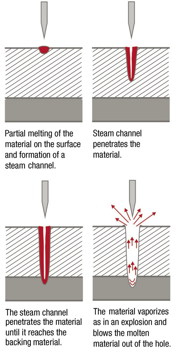

Like the cathode-ray tube in that tired Motorola, an EBD gets its mojo by electrically heating a cathode, which responds by emitting a cloud of electrons. This cloud is then accelerated with a bias voltage and the resultant beam is shaped through a series of electromagnetic lenses and directed at the workpiece (see graphic on page 98). When the beam hits, the atomic particles plow into the workpiece at two-thirds the speed of light, superheating the material to 2,700° C (4,892° F).
The particles don’t stop until they hit a backing sheet—made from a polymer or other relatively low-melting-point material—which is applied to the workpiece prior to machining. This backing material vaporizes on impact, creating a gas bubble at the bottom of the hole.
The result is like Mount Vesuvius on its worst day. A cylinder of molten material is ejected from the workpiece, leaving behind a smooth hole between 60μm and 5mm in diameter, at aspect ratios up to 25:1. The electron beam turns on and off rapidly, or pulses, between holes.

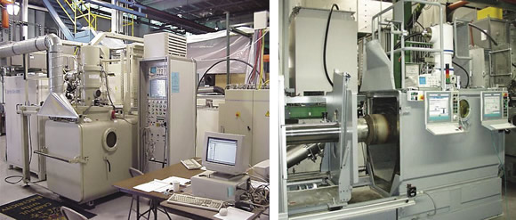

Type PK 14 (left) and Type PK 20-3 electron beam drilling machines from pro-beam.

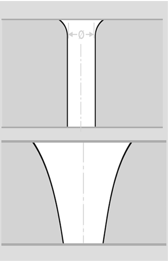

Boehme said EBD can do far more than just make round holes: “You can influence the shape of the beam by moving it in a helical or oscillating direction. The distribution of power into the workpiece then becomes noncylindrical. The molten material is blown out of the resulting shape in a single pulse, creating ovals, slots and even complex shapes very quickly.”

Electron beam drilling can produce holes with a variety of different shapes, such as these examples.

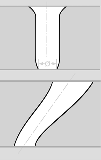

Still, doing anything this quickly can cause errors. “Depending on what kind of holes you are trying to make, it’s sort of like a racecar,” said Greg Albares, owner of Particle Beam Tech Inc., a job shop in Roebuck, S.C. “You can push for a higher speed, but you may lose some handling.”
As Albares explains, making holes this fast and close together is often problematic. EBDs’ high energy can lead to warpage and movement of the workpiece, causing inaccuracy. Flying debris might interfere with the beam, and ejected material can stick to the workpiece surface, affecting adjacent holes.

The electron beam drilling process.
“Sometimes, you have to limit the machine’s power to reduce heat effects or play around with the focus,” he said. “It’s all about optimizing process parameters—such as average power and pulse duration—until you find a robust process. It’s very part specific, but once you find the right mix it’s quite repeatable.”

Want to join the elite club of EBD shops? You’ll need some serious cash. “You’re looking at $1.5 to $2 million for a decent-sized driller, which means a vacuum chamber with a couple cubic meters of capacity and 20kW to 30kW of power,” Rugh said. However, these machines are so fast and productive that a shop considering a new EBD might be able to do in a week or so what previously took them a year, leaving the machine idle unless the shop can generate new business. “In that regard, it can be hard to justify the investment,” he said.
