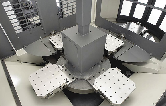

Courtesy of Methods Machine Tools
A four-station pallet pool services a pair of KIWA KH-45 horizontal machining centers.

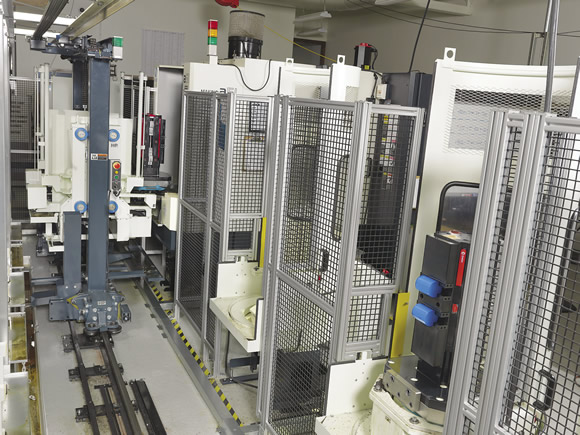

Courtesy of Big River Engineering & Manufacturing
Big River Engineering’s linear pallet system in action.

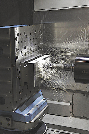

Each side of the aluminum parts on this tombstone can be machined in a single cycle.

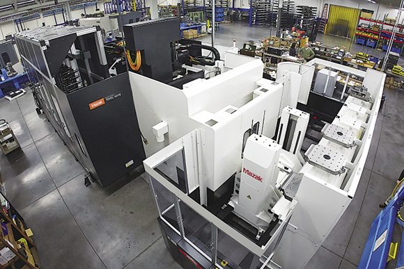

Courtesy of Choice Precision
Choice Precision uses a double-level, 12-pallet stocker station Palletech manufacturing system paired with a Mazak Variaxis 730-5X II 5-axis vertical machining center.

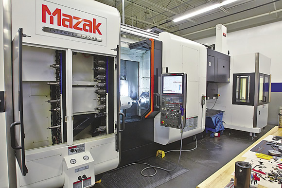

The Mazak Integrex i-200S multitask machine at Choice Precision flexibly and efficiently processes parts.
