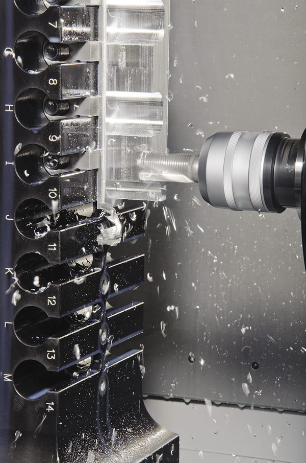

Greater part fixturing possibilities exist on HMCs compared to VMCs. Image courtesy Makino.
Horizontal machining centers' enhanced capabilities shorten payback periods
HMCs also accommodate more flexible workholding options, Baldus noted. Four-, six- and even eight-sided tombstones, double-sided window frames and dedicated hydraulic or high-density fixtures are common on HMCs, making them a favorite of high-volume shops. Prototype and low-volume manufacturers benefit as well from the ability to setup multiple jobs on each tombstone on an HMC.

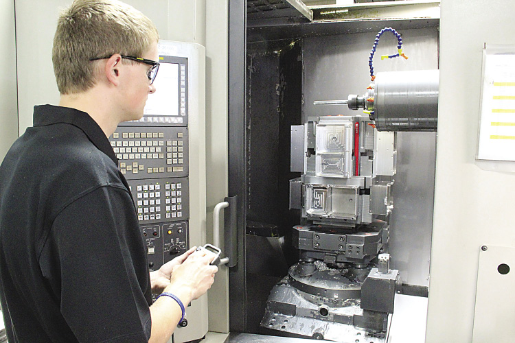

It might take getting used to, but machine operators can easily adjust to a horizontal world. Image courtesy Baum Precision Machining.
Still, it’s hard to argue with the efficiency gains most shops see after taking the horizontal leap of faith. One such shop is Baum Precision Machining Inc. Before acquiring its first KIWA in 2008, a KNH-426X 2-pallet horizontal, the shop made all its parts on 3-axis VMCs, often requiring three to five operations. By allowing parts to be made in one or two operations, HMCs have greatly decreased the Pipersville, Pa., shop’s setup time, said Aaron Baum, company president. And because multiple pallets mean multiple jobs are set up simultaneously, there’s greater flexibility to meet changing customer demands.
Spindle utilization has increased to 90 percent or more during the 24-hour, 6-day workweek at Baum Precision. Because of this success, the company has since added a pair of 6-pallet-pool KIWA KH-45G HMCs and upgraded its original machine to match that pallet configuration. “We find one horizontal can do the work of three or four verticals,” Baum said.

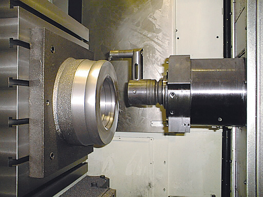

Being able to turn a workpiece on an HMC significantly expands its machining potential. Image courtesy Okuma America.

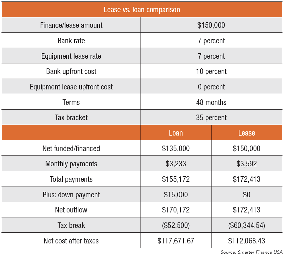

What’s the best way to pay for that new horizontal or vertical machining center?
“It depends,” said Rob Misheloff, president of Smarter Finance USA, Irvine, Calif. “Large shops look at very different and possibly far more expensive machines than do small ones and often have far different cash flows, credit ratings and tax considerations.”
For businesses with large cash reserves, the simplest answer might be to make a sizable down payment or even buy the machine outright. This minimizes interest payments and gets the equipment paid off quickly or immediately. Misheloff warned, though, that paying cash may be unwise.
“Folks are usually poorly served by paying cash for a machine,” he said. “It eats up working capital, and the tax advantages of leasing are often so great that financing costs after a tax rebate are free—or even less than free.”
Less than free? Though not always the case, but Misheloff said companies with good credit can see significant savings by leasing equipment, once federal and state tax rebates are considered. Fair-market-value (FMV) leases allow shops to skip the down payment, pay less over the course of the lease and write off the monthly payment to boot. So-called “dollar out” leases are usually loans by another name, but do offer some tax advantages. And straight financing allows equipment to be depreciated over the loan term—or longer—but may cost more in the long run.
“Again, it really depends on the situation,” he said. “Because a shop can turn in the equipment at the end of an FMV lease, it’s easier to stay current on technology. Other shops think it makes sense to pay off a machine and run it for 20 years. We typically tell clients, the better your credit, the longer your term should be. On the other hand, start-up shops might want to pay off the machine more quickly, since lower credit scores mean higher interest rates. The best advice is to shop around, evaluate all the numbers and make sure you look at the big picture.”
