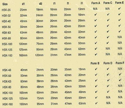

The use of HSK assemblies has been growing significantly since 1993, when DIN (the German standardization organization) issued the HSK shank standard, DIN 69893, for the six forms of the design (Figure 1). While most of these forms are considered specials, forms A and C are manufactured in Germany as stock standard styles, and the International Organization for Standardization (ISO) and the American National Standards Institute (ANSI) will probably use these forms as the basis for their HSK standards. Certain manufacturers sell versions of HSK toolholders that are proprietary and do not conform to any currently recognized standard. Although there is some variation in the HSK styles available, some generalizations can be made about the features of the HSK design and the benefits it offers users.

Table 1: The dimensions of HSK toolholder forms A, C and E (top) and forms B, D, and F (bottom). A check mark indicates standard sizes; N/A indicates sizes not in the standard.

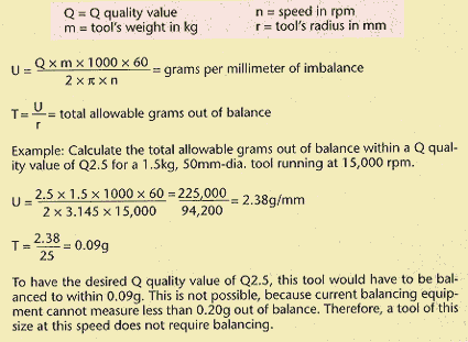

Keep it balanced. HSK toolholders typically are used at high speeds, because their design is so well-suited to this type of machining. Users must realize that the need for properly balanced tools rises with the increase in rpm. To correctly balance their tools, users must understand what Q quality means in the context of balance specifications.
All dynamic objects have a certain amount of vibration or imbalance. Q quality is a hypothetical value that quantifies the inherent imbalance of a dynamic or rotating tool. Generally, this value is Q2.5 for rotating tools.
Q quality is not the same as what the ISO 1290 G standard refers to as grams per millimeter (g/mm) of imbalance. For example, a tool rated at Q2.5 is not 2.5g/mm out of balance. As shown by the first formula in Figure 4, the tool’s imbalance in g/mm (“U”) is derived from the Q quality value (“Q”), the tool’s weight in kg (“m”), and the speed in rpm (“n”).
Figure 4: The formulas necessary to calculate tool imbalance within the desired Q quality level.
Users cannot bring their tools any closer to perfect balance than the accuacy of the balancing equipment will allow. Current equipment balances to an accuracy of 0.20g. Up to now, this degree of accuracy has been more than sufficient. As shown by the second formula in Figure 4, the total allowable grams out of balance (“T”) within the desired Q quality value is calculated by dividing the tool’s imbalance in g/mm (“U”) by the tool’s radius in mm (“r”).
As the rpm increases, the maximum grams a tool can be out of balance decreases. Because tools can only be balanced to an accuracy of 0.20g, tool imbalance doesn’t become a problem unless the total grams of imbalance (“T”) is equal to or greater than 0.20g. If “T” is less than 0.20g, the tool generally doesn’t require balancing.
