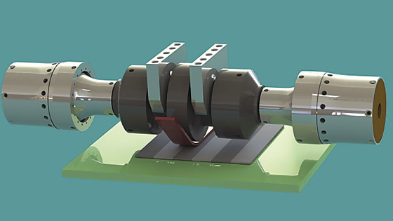

Fabrisonic’s ultrasonic additive manufacturing technology bonds layers of metal foil using a welding head.

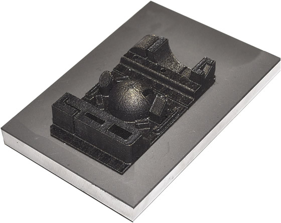

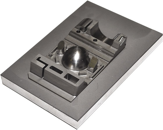

MC Machinery Systems Inc. also offers a hybrid machine tool: the Lumex Avance-25 from Japan-based Matsuura. Although the additive portion is called direct metal laser sintering, Greg Langenhorst, technical marketing manager for the Wood Dale, Ill., distributor, said that description is a misnomer. “We’re actually laser-melting material together.”
An example of sintering, on the other hand, is the production of tungsten carbide, where the various elements are mixed, heated and put under pressure to bond together. “That’s an honest-to-God, true sintering process,” Langenhorst emphasized.
Semantics aside, the DMLS process starts with a base plate, or ground-flat piece of hot-rolled steel, bolted to the machine table, Langenhorst explained. A squeezing bar deposits and squeezes the metal powder on the base plate to a thickness of 50µm (0.0019 “), the laser melts the powder based on the part’s NC program, after which the table drops 50µm and another layer is squeezed and melted on top of the previous layer.
Typically, after 10 layers the machine performs rough and semifinish milling at up to 45,000 rpm, Langenhorst said, noting the number of layers sometimes varies. The semifinishing tool leaves about 0.0015 ” (0.038mm) per side oversize. After the next 10 layers are deposited and melted, they are roughed and semifinished, and the previous 10 layers are then finished with a shank-relieved tool. “The reasoning for that is every time you start a new set of layers, it has a tendency to shrink the edge a little bit,” he said, “so we eliminate the witness line for every set of 10 layers. Finish milling is always one step below what you just created.”
Similar to other hybrid machining processes, DMLS enables creating conformal internal cooling channels and deep ribs as thin as 0.028 ” (0.711mm) without having to design electrodes and apply them via sinker EDMing. It also eliminates mold die splitting, which means that a multiple-piece assembly can be built as one piece, saving a significant amount of assembly time and reducing part weight and the complexity of building multiple pieces, according to Langenhorst. EDMing can still come into play with hybrid machining, but in the form of wire EDMing to remove the completed part from the base plate.

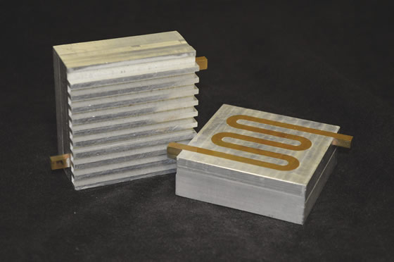

A hot melt works well when building P/M parts, but that approach isn’t suitable for some applications. Fabrisonic LLC offers an alternative method of 3D printing that doesn’t melt the metal and incorporates it into a milling machine. The company scaled up ultrasonic welding technology, which the electronics industry has long used to weld dissimilar metals on a microscale level, to produce parts in a machine with a work envelope up to 6 ‘×6 ‘ (1.829m × 1.828m), said Mark Norfolk, president of the 3-year-old, Columbus, Ohio, company (see photos on pages 54 and 60).
Fabrisonic’s ultrasonic additive manufacturing (UAM) technology bonds layers of metal foil measuring 0.006 ” (0.152mm) thick at a rate of 15 to 20 cu. in. (381mm to 508mm) per hour using a welding head, Norfolk explained. Oxide layers prevent metals from sticking outside of a vacuum, so UAM rubs off the oxide layer by vibrating the foil with sound at 20 kHz, mating virgin metal with virgin metal—even dissimilar ones—to achieve specific engineering properties.

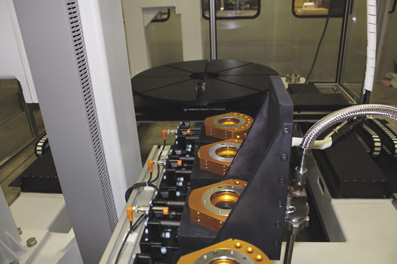

The toolchanger on FRE’s 6-axis VDK6000 robotic work center has four stations for additive manufacturing tools. The cell also provides subtractive capabilities, including milling, drilling, grinding and polishing.
“If you were to take titanium and aluminum and melt and resolidify them, what you would end up with is a brittle intermetallic, almost like glass,” he said. “With our process, because we’re not melting, we can make a solid-state metallurgical bond at that interface without getting that intermetallic.”
The process isn’t a completely cold one, with temperatures from 200° to 250° F (93.3° to 121.1° C), as well as a down force of about 1,000 lbs. (454 kg) required to create a bond, but it’s cool enough to avoid changing the material’s metallurgy or grain structure and to enable embedding electronics in a part, Norfolk noted. However, the force exerted by the welding head creates problems with overhang features where there’s no support. “Typically, we overcome those with special endmills that have an undercut to them, playing tricks like that using the CNC machining side to get undercuts as opposed to printing the undercuts.”
Process%20Compare-Sintered.tif
Process%20Compare-Finished.tif
Courtesy of MC Machinery Systems
An example of a laser-sintered part produced on the Lumex Avance-25 hybrid machine and one that was sintered and machined.

“Like Lego blocks for real,” is how Dr. Vojislav Kalanovic, president of Flexible Robotic Environment and a professor of mechanical engineering at South Dakota School of Mines and Technology, describes how FRE’s VDK6000 hybrid robotic work center distributes its degrees of freedom and space to suit a specific application.
The standard system comes with six degrees of freedom to build complex parts and synchronously manipulates an end effector in 3D space to achieve full orientation and positioning of the head with respect to the workpiece, according to the Rapid City, S.D., company (See photo on pages 56-57).
Kalanovic added that the robotic work cell is scalable up or down, and users on a budget can start with only three degrees of freedom, for example, and add additional degrees as needed at a later date. In addition, a cell with six degrees of freedom can be configured with an additional redundant axis. “Our specialty is motion,” he emphasized.

Because it doesn’t melt metal, Fabrisonic’s ultrasonic additive manufacturing enables users to embed electronics in a part.
The work cell has a toolchanger with four stations for additive manufacturing processes, such as plasma welding, cold spraying or direct metal laser deposition, and can be expanded to eight, Kalanovic noted. “You might not be able to use certain technologies in sequence for process-related reasons.”
On the subtractive manufacturing side, the VDK6000 can perform milling, drilling, grinding and polishing, as well as ultrasonic inspection part verification after processing. “You can combine processes and mimic a mini factory that will help you save a great deal of time,” he said. “Out of one fixturing you can perform a series of operations that normally take various kinds of machines to complete.”
Kalanovic estimates payback for the work cell, which can cost from $600,000 to $1.3 million, is 12 to 14 months. The overall workspace is 1.2m × 1.2m × 0.9m (3.94 ‘×3.94 ‘×2.95 ‘) and, in addition to building parts, can accept parts weighing up to 80 kg (176.4 lbs.) for repair. The cell’s footprint is about 4m × 5m × 4.5m (13.12 ‘×16.40 ‘×14.76 ‘).
