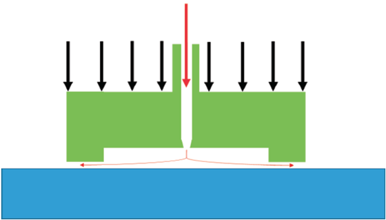

Figure 1. A hydrostatic bearing with insufficient pressure to lift the load.
Figure 1 illustrates a bearing supporting a table. The bearing body (green) has a pocket between it and the nonmoving guide way (blue). At the moment shown, the oil pressure (red) is not enough to support the load (black), and the bearing and the table are in contact. As the pressure is increased, the force between the two components (oil pressure × pocket area) also increases.
When the pressure is great enough to overcome the load, the bearing lifts off the guide way and a small amount of oil begins to flow from the pocket out through the small gap between the bearing and the guide (Figure 2 below). Because the thin film of oil in the small gap prevents mechanical contact, the only force opposing sliding motion between the bearing and the guide way is fluid friction. This low-friction condition is maintained as long as oil flows.

Figure 2. A hydrostatic bearing with a thin oil film separating the moving elements.

In Figure 2, the bearing is stiff when the load is applied toward the guide way, but not as stiff when the force acts to separate the bearing. For this reason, hydrostatic bearings are often designed in pairs to provide bidirectional stiffness.
