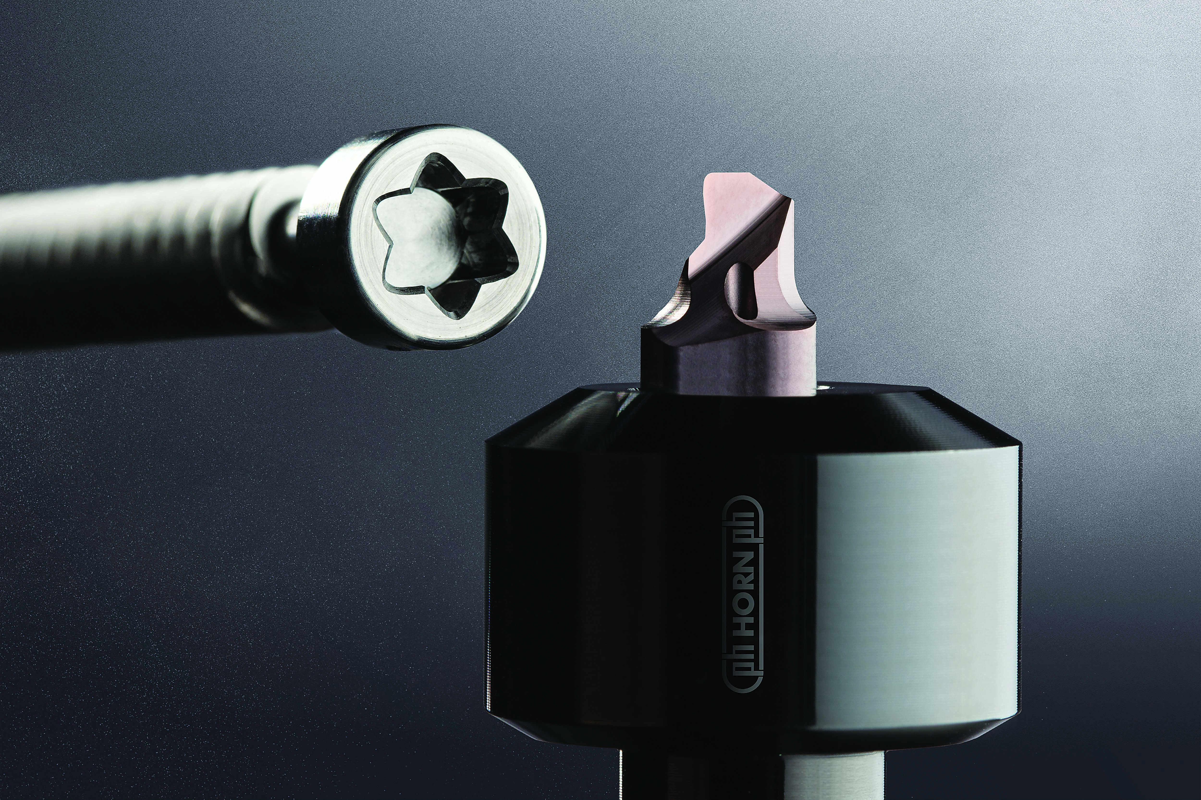

The other turning-based ZykloMed process, polygon turning, produces non-circular external and internal contours with the shape of a hypotrochoid. In this process, parallel tool and workpiece axes are offset from each other by a certain distance and rotated in accordance with a specific speed ratio. The offset distance and speed ratio, as well as the cutting diameter of the inserts, determine the dimension of the machined contour.
“Our idea was to use this technology to cut an internal profile which looks very similar to a Torx profile,” Sellmeier said. Such a profile, he noted, is often machined into the heads of bone screws to produce a very rigid connection with the screwdriver.
From a manufacturing standpoint, he said, the problem with Torx profiles is that machining them the conventional way is a time-consuming process in which very small end mills are needed to cut the small corners of the shapes. On the other hand, he said, a simple polygon turning tool can cut a shape very similar to a Torx profile in 9 seconds, making the process about 13 times faster than conventional Torx cutting.

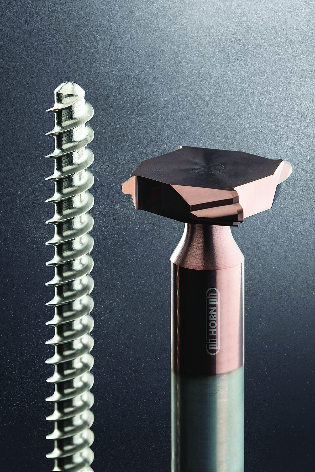

The third ZykloMed process, high-speed whirl milling, is a new option for producing bone screw threads. In the conventional whirling process used to machine these threads, the workpiece rotates slowly while inward-pointing inserts on the rapidly rotating whirling head do the cutting. In high-speed whirl milling, however, the conventional whirling head is replaced by one or two circular milling cutters with outward-pointing cutting edges. Another important difference in the new process is that the workpiece rotates at a high speed that is coupled with the cutter speed. The cutter-to-workpiece speed ratio depends on the number of threads and the number of cutter inserts. The direction of cutter rotation can be the same as or opposite to that of the workpiece.
High-speed whirl milling was developed for economical production of bone screw threads.
High-speed whirl milling was developed for economical production of bone screw threads. Image courtesy of Horn
According to Sellmeier, high-speed whirl milling produces better surfaces than conventional whirling and is also much faster. In addition, the process makes it possible to economically produce bone screw threads with a variable pitch.
Sellmeier also noted that users of high-speed whirl milling have the option of cutting the fast-rotating workpiece parallel to the whirling process with a turning tool. He explained that this can be helpful in situations where the head of the bone screw being cut has a diameter that is much larger than the outer thread diameter. In these cases, the parallel turning process can be used to remove the excess material between the two diameters.
“Therefore, you need to cut a lot less material with the whirling process,” he said, adding that this extends the life of the whirling inserts.
