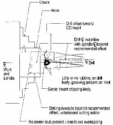

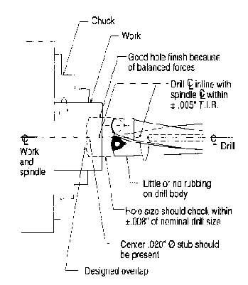

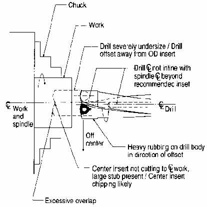

The key to preventing tool deflection when using an indexable drill is to balance the cutting forces on each of the opposing inserts. The use of trigon inserts in indexable drills helps to ensure this balance. The trigon insert geometry stabilizes the drill in the cut, reducing tool deflection and improving penetration rates. Drills equipped with trigon inserts also are more versatile than those with conventional insert shapes. As illustrated in Figure 2, trigon-insert drills perform well in interrupted cuts and on a variety of workpiece surfaces, including flat, convex, concave, sloped, and irregular. Additionally, these tools can drill from solid, drill holes that are larger than the drill diameter, core drill, bore, and turn and face outer diameters when applied on a lathe.
A trigon-insert indexable drill leaves a well-defined pattern or “footprint” at the bottom of a blind hole or on the disk that is ejected from a through hole. This pattern is generated by the insert shape and the position of the drill. Examination of this footprint can reveal much about the drill’s performance.
Indexed for Success Figure 2: Indexable drills can machine holes in parts with a variety of nonflat surfaces. They can also bore and make interrupted cuts.
On the disk or hole bottom, there is a stub surrounded by four distinct rings for double-insert drills. The outer two rings are generated by the outboard insert, while the inner two rings and the stub (ideally measuring 0.02″ in diameter and 0.01″ high) are created by the inboard or center-cutting insert.
The stub is created because the inboard insert station is positioned below center by 0.01″ radially. This positioning allows the inboard insert to cut past the center. If the stub measures 0.02″ in diameter, the drill is cutting to its designed diameter with little or no deflection (Figure 3a).
If there is no stub at all, it means the drill is either misaligned or deflecting oversize radially or axially, or a combination of the two (Figure 3b). When this happens, the inboard insert will probably chip at the drill’s centerline. This situation can be corrected by modifying the feed rate or realigning the drill.
If an overly large stub is present, it may mean that the inboard insert is being pulled off centerline radially or being pushed further behind center axially (Figure 3c). This condition will result in undersize holes and can be more damaging to the drill and inserts than if no stub were present.
To prevent these maladies, check all indexable drills for location with an indicator while in the machine tool. If the location varies by more than ±0.005″ TIR, then repositioning is necessary.
Chatter marks may also be present on the footprint, indicating that speeds and feeds should be modified. In most cases, increasing feed rates will eliminate chatter.
The finish of the rings also offers clues about the tool’s performance. At optimum speeds and feeds, the outer two rings cut by the outboard insert will be bright and the inner two will be dull.

Indexed for Success Figure 3b: An indexable drill machining oversize.
Indexed for Success Figure 3c: An indexable drill machining undersize.

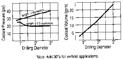

Once the chip has been broken, the next challenge is to get it out of the hole. Poor chip evacuation can cause chip recutting, insert chipping, and even drill failure. The efficiency of chip evacuation depends upon chip control, coolant pressure, coolant volume, and hole depth. Figure 4 offers coolant guidelines for achieving optimum chip-evacuation efficiency.
Indexed for Success Figure 4: These graphs show recommended coolant volumes and pressures for various drilling diameters.
In indexable drilling, it is imperative to remove the heat generated in the chip during the machining process, because indexable drills generate more heat than HSS or solid-carbide drills do. However, in drilling, the heat zone is a confined area at the bottom of the hole. Therefore, coolant acts as a carrier to transport both heat and chips from the bottom of the hole to the mouth of the hole through the flutes. For this reason, running indexable drills larger than 1 diameter without liquid coolant usually leads to drill failure. A full-flow water-base or synthetic coolant is generally recommended.
Many machine tool builders supply high-pressure, pulsating coolant systems with new machines. These coolant systems can generate pressures up to 300 psi, but they are limited to very low gpm ratings, usually a maximum of 5 gpm. At first glance, these systems, when combined with indexable tooling, appear to be highly efficient, but there are some disadvantages to consider:
  1. High-pressure systems are not capable of delivering gpm ratings up to indexable-drilling requirements. As a result, indexable-drill life suffers, even when coated inserts are used. Since the volume of coolant is insufficient, excessive heat will occur during the machining process.
  2. Pressures of 300 psi combined with a pulsating action can actually affect chip control and deflect the drill. The high pressures can flatten chips at the point of forming and force them back into the cut, causing chip recutting, insert chipping, and poor hole finishes.
  3. High pressures can force chips into clearance areas between the drill body and the hole wall. Chips will then wrap around the drill and become friction welded to either the drill body or the hole wall.
When applying indexable drills on high-pressure coolant systems, first try to push the coolant volume above 10 gpm. (If you can’t, you may need to peck-feed the drill.) Then reduce or discontinue the pulsator and run only with straight, constant pressure. Finally, reduce the pressure to 100-150 psi if possible.
Because of the importance of high-volume coolant delivery to the point of cut when using indexable drills, all indexable drills are manufactured having the largest coolant holes possible for a given drill diameter. This ensures that maximum coolant volume can be delivered to the cutting edge.

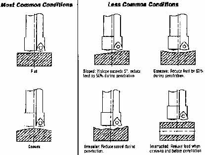

Some applications approach the limits of what indexable drills can do. Special care must be taken in these instances to ensure a successful operation. For instance, when applying indexable drills in deep-hole operations (greater than 4 diameters) or when entering a very rough or uneven surface, it may be necessary to halve the feed rate until the drill penetrates the workpiece to a depth of about 0.1″. This allows the drill to generate its footprint in the workpiece and create a clean, straight hole, and it helps eliminate insert chipping. The feed rate should also be halved when the drill exits surfaces that are uneven or rough to help prevent insert chipping.
As a general rule, it’s not a good idea to use indexable drills to make holes deeper than 4 diameters. Starting a long indexable drill in the cut is difficult, because the drill lacks rigidity, evacuating chips is a problem no matter what coolant system is used, and the tool is more likely to deflect. These factors add up to poor hole finishes.
Although an indexable drill generates approximately 30% fewer axial thrust pounds of force than a conventional HSS twist drill does, it still requires a very rigid machine tool and fixturing. If the spindle is not tight and properly adjusted, the drill will not perform as designed. The drill will cut off-center, resulting in oversize holes, poor hole finishes, and, in some cases, insert chipping. Similarly, an inadequately fixtured workpiece will render indexable drills ineffective, resulting in higher horsepower requirements and excessive axial thrust forces.
An indexable drill should not be applied to radial- or post-type drilling machines. Also, applying an indexable drill halfway up column-type machines can cause a severe loss of rigidity in the column, making it less able to resist axial thrust forces and torque forces generated when using indexable drills. Never apply the drill more than halfway up the column.
Also avoid using indexable drills to generate holes in laminated or stacked materials. Remember, all standard indexable drills produce a disk as the drill exits the hole, or in this case, as the drill exits one layer and enters the next. This disk becomes trapped between layers and causes severe tool damage or complete failure of the drill. The latter is more likely.
