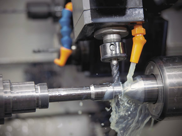

Every shop eventually faces the prospect of finishing parts with intersecting holes. Many inexpensive solutions exist, but the process begins with a clear definition of the need.
For example, Peter Gillespie, engineering manager at Shinn Fu Co. of America Inc., Kansas City, Mo., maker of hydraulic jacks, had the following scenario. A hole in the main jack cylinder and an internal seal passes over the edge of a hole, and sharp edges or burrs can damage the seal. “Is there is an economical way to smooth that edge to prevent or reduce seal damage?” he asked. “Because it’s on a curved surface, most of my ideas are not working.”
Assuming nothing Gillespie does while finishing the interior impacts the exterior, he needs a more complete definition for the intersection requirements.
The two most common requirements for hole intersections are deburring and providing a sealing edge at the intersection. For example, fuel injector holes must have no loose particles, burrs or rough edges that will negatively impact fuel flow, and hydraulic system holes require smooth surfaces for precise flow and minimal leakage around seals.
The author’s experience required finishing miniature holes in stainless steel, removing burrs visible at 30× magnification while assuring that the finished intersection had no more than a 0.001 ” radius. Each requirement necessitated different solutions.
