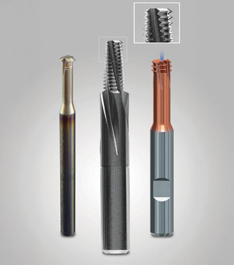

Three styles of thread mills made by EMUGEFRANKEN(from left): the EMUGE THREADSALL (single-plane), the EMUGE MultiTHREAD (multi-plane) and the EMUGE THRILLER (threeplane). EMUGE
Thread mills are made in a variety of styles (see image). I've already explained the operation of single-plane tools above. With this type of thread mill, each tool can cut a variety of thread pitches and diameters. There are also multiplane tools where each plane, or cutting tooth, has the same cutting diameter. These tools will cut multiple pitches of the thread in one rotation of helical interpolation. Plus, there are tools with three planes that each have different cutting diameters. So, the first plane roughs, the next plane increases the thread diameter and the last plane finishes. Seems to me that such a thread mill would be great in really ornery material like nickel alloys.
