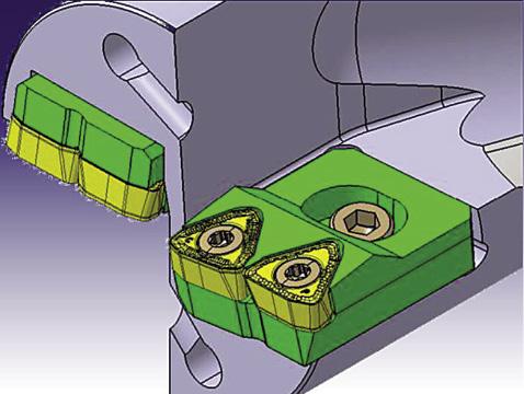

The drills for large-diameter holes are from the TungDrillBig series, which have new replaceable cartridges to accept TungSix-Drill WWMU-type indexable inserts with six cutting edges. The cartridges are also adjustable, enabling any of the five available tool bodies to produce multiple hole sizes.

Tungaloy’s TungDrillBig drill body accepts TungSix-Drill indexable inserts with six cutting edges, and its diameter can be adjusted with the use of setting plates.

Zeitz appreciates that all four pockets in the drill accept the same insert instead of one insert for an inside pocket and another for an outside pocket. The only difference is the cutting edge on the outside insert wears a bit faster because it removes more metal. He added that the chip shape varies, depending on insert location. The center insert generates tightly curled chips, the outside insert produces chips with kinks and chips from the two inboard inserts flow like ribbons.
