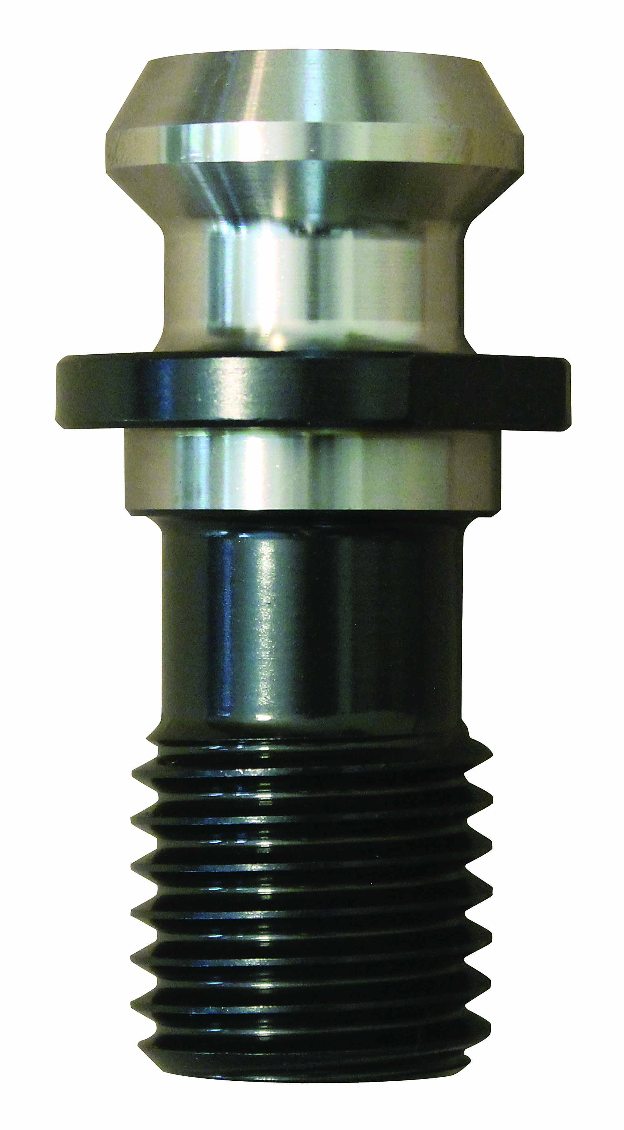

A High Torque retention knob from JM Performance Products. Image courtesy of JM Performance Products
Stability is essential to achieve optimal results when milling challenging materials. The entire machining process must be considered. Any one element could impede the overall effectiveness of the process. The cutting tool, holder, spindle, machine tool, fixturing and workpiece are all part of the interconnected “machining circle.”
After investing in a Matsuura H.Plus-405 horizontal machining center, Delta Machine Co. LLC, Gardena, California, realized that one critical factor to not breaking this circle is to have a properly balanced toolholder in the spindle, said President Janos Garaczi. When he purchased the HMC, Garaczi followed the machine builder’s recommendation and purchased High Torque retention knobs from JM Performance Products Inc., Fairport Harbor, Ohio. The knobs, which enhance the seating of a holder in the spindle, are longer and reach deeper into the cross section of the holder’s threaded bore than standard retention knobs, JMPP reports. As a result, all thread engagement occurs in a region of the toolholder where the cross section is thicker to resist deformation.

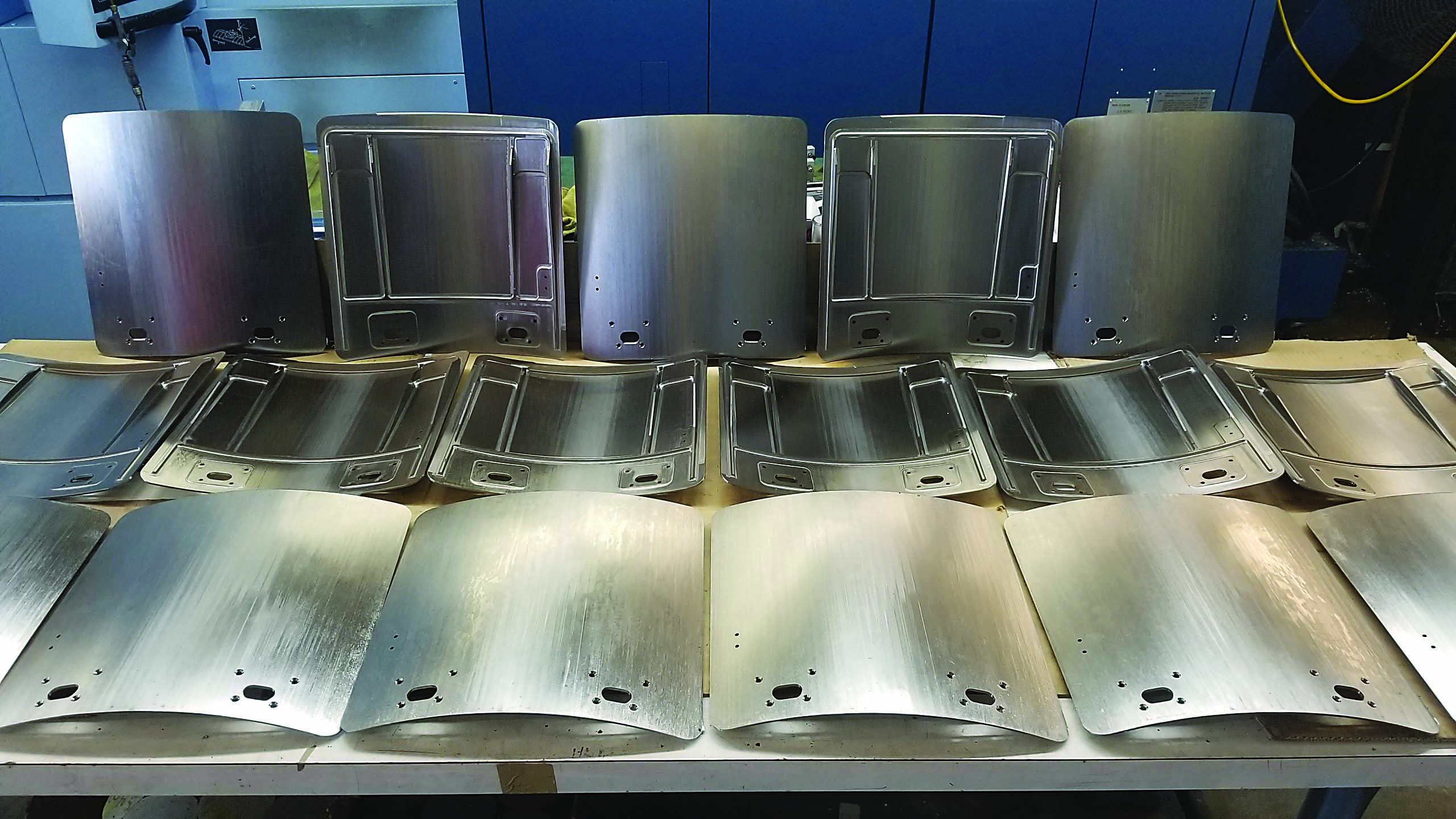

High Torque retention knobs help Delta Machine impart fine surface finishes and eliminate secondary benching operations. Image courtesy of Delta Machine

With the purchase of each machine, Delta continued to buy more High Torque retention knobs. Although they cost about three to four times more than a standard knob, the payback through longer tool life, shorter cycle times and finer surface finishes is quick, Garaczi said. “Even if you pay $4,000 more for 200 knobs, it’s going to bring this money back in a couple of months—easily. For us, it’s a no-brainer.”
He estimates that the retention knobs from JMPP help increase tool life from 20 to 30 percent and eliminate the need for secondary benching operations. One part for the Boeing 737 MAX program, for example, required about 3 hours of bench work to blend the machined surfaces when another machine shop produced it, Garaczi said. After Delta received the job, bench work wasn’t necessary.
“One day, the head inspector saw the first article and started touching it,” Garaczi said. “The first thing the guy said was, ‘You don’t need to produce such a good finish.’ Without any benching, we can achieve a surface finish of 32 to 40 rms.”
He added that the High Torque retention knobs help Delta boost its cutting speeds. “We’ve been able to cut cycle times by 40 to 50 percent compared to other shops.”

Savings are also potentially realized by avoiding spindle damage when a machine’s high torque shears off or breaks the retention knob, which is a scenario Garaczi said he’s heard about for standard knobs. Replacement spindles cost $40,000 or more, not including the cost of downtime. “And that’s not covered by the manufacturer’s warranty.”
