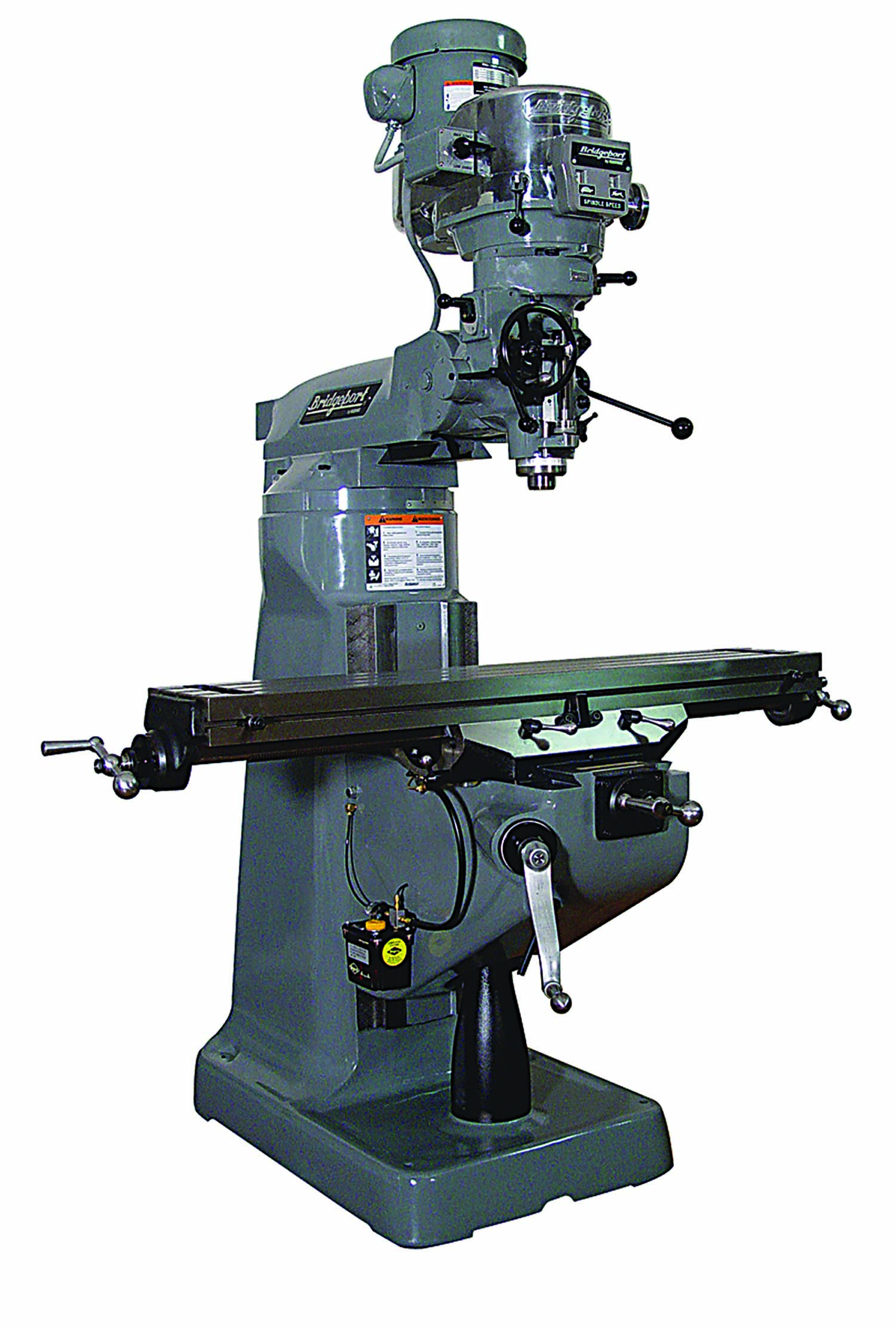

The design of the knee mill goes back to 1936, when Rudolph Bannow's company produced a knee-and-column vertical mill with a rotating turret and sliding-ram head. The mill became known by the company's name—Bridgeport—which, like Kleenex, became the generic signifier for mills of similar design.
Eighty years is a good run for a single design. But now we often hear that the venerable knee mill's time must be closing. Newer, multiple-axis CNC machines that can do much of what the knee mill can—and more—will fill its niche.

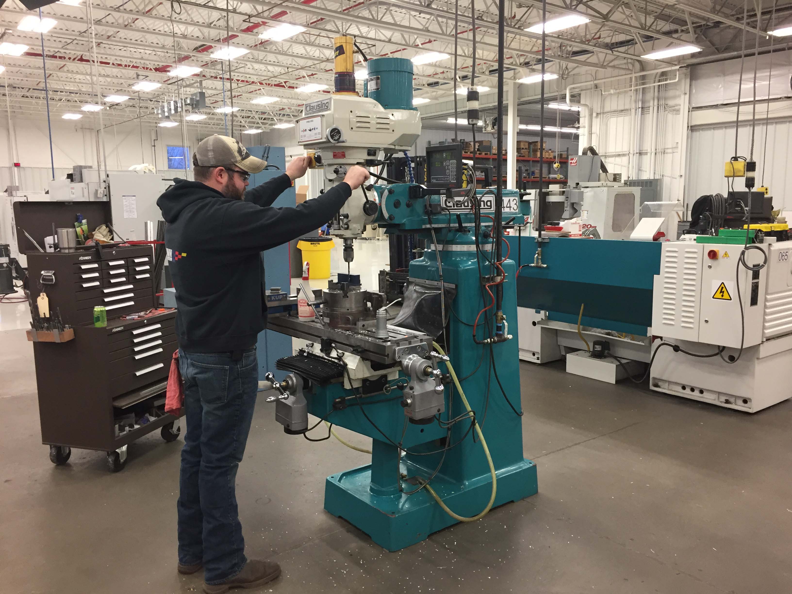

Machinist Bruce Lloyd sets up an operation on one of the two Clausing manual knee mills at Munn Manufacturing. Photo courtesy of Munn Manufacturing.
Simplicity and Speed
Munn Manufacturing, Freeport, Mich., uses 12 CNC mills and 11 CNC lathes for complex tooling and production runs for aerospace, heavy truck, automotive and aftermarket work. Started in 1963, the company has sections for production machining, tooling and pipe bending. About 2 years ago, the company purchased two Clausing manual knee mills "for use on jigs, fixtures and the like," said owner Steve Buehler.
"Sometimes it's just easier to put a part into a knee mill, pop in a couple of holes or tap something, make a little cut in it and you're done." Buehler contrasted that with the longer work of programming those tasks on a CNC mill. "Sometimes the knee mills are just easier for us. That's why we keep them here."
Kevin Mungovan, president of Clausing Industrial Inc., Kalamazoo, Mich., thinks cost is an important reason why the knee mill remains popular. "Why pay more to drill a hole than you need to? You could put a 2-axis control on a knee mill, take the part off the $100,000-plus machining center and put it on a $30,000 knee mill. Let it do what it does well—drill the bolt pattern. Let that other machine do what it does best—make chips," he said. "We're seeing more applications where the knee mill provides support for a CNC machining center. Or it is used for a second operation."
That's in line with how Munn Manufacturing uses its knee mills, according to Buehler. "Suppose a run on a CNC machine is from 30 minutes to an hour," he said. "While it's going on, our machinist can make other parts on a knee mill—or on a manual lathe, if that's what is needed—instead of trying to program the tasks into a CNC mill or lathe.

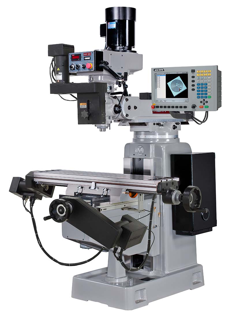

Kent makes a CNC version of the knee mill, as do others. The Kent version features "an easy-to-use, conversational control that's ideal for small shops learning or getting into CNC machining at a more affordable starting price," Young said. "They are also handy for full CNC shops when doing a second operation, prototyping or quick, small-lot-quantity part runs."
Another benefit for small shops: "Many of our models can also run on single-phase power, so they can be put into a 'garage' shop for someone who is just starting out," Young said.
