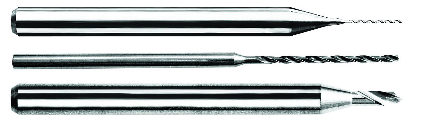

Multiple methods are available to make a miniature hole. In the past, laser micromachining and electrical discharge machining were frequently the default options because of technical limitations with the grinding machines used to produce the required geometries on solid-carbide microdrills, said Jake Rutherford, research and development engineer for Kyocera SGS Precision Tools Inc. in Munroe Falls, Ohio.
“The new grinding machines have a tremendous amount to do with making accurate geometries that small,” he said.
Nonetheless, a cutting tool manufacturer designs microdrill point geometries to suit not just the intended application but the production of the drill, said Sarang Garud, product manager for Walter USA LLC in Waukesha, Wisconsin.
“The extremely small size of the drills makes it pretty hard to manufacture the drills,” he said, “and design for manufacturing governs some of the drill design decisions as well.”
Garud said two important factors when designing microdrills are cutting force reduction and secure chip evacuation.
Rutherford said he considers any drill with a diameter smaller than 3.175 mm (0.125″) to be “micro.” Kyocera SGS Precision Tools offers standard microdrills down to 0.041 mm (0.0016″) and ones with through-coolant capability as small as 1 mm (0.039″) for producing holes up to 15 diameters deep.

“Microcutting tools are not simply a reduction in size,” he said. “With each downsizing step, the degree of difficulty increases exponentially. The smaller the surface area of the tool, the more difficult it is to manufacture the geometry while maintaining the required quality and tolerances.”
