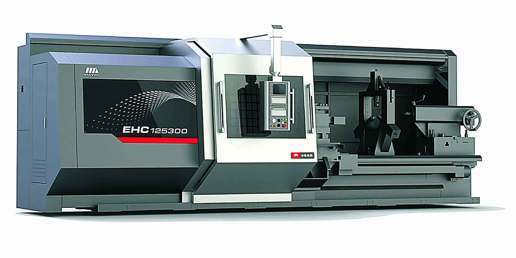

Priced at $269,000, SMTCL’s EHC125300 is a CNC horizontal lathe that can turn out parts up
to 3m (118″) long. Standard features of the 44,000-lb. (19,958kg) machine include a 1,000mm (39.4″) chuck, 8-position turret, steady rest, hydraulic tailstock and chip conveyor.

The new EHC125300 horizontal turning center from SMTCL is designed to be an economical option for job shops turning large parts. Image courtesy of SMTCL USA.
