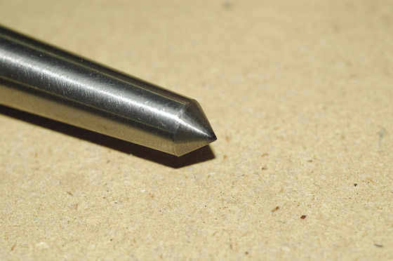

Grind the tip of a center punch to a 90° included angle.

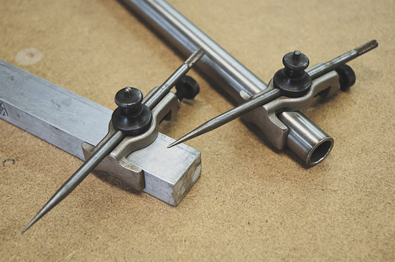

For larger fabrications and arc layout, trammel points that clamp to common bar stock sizes are excellent options.

When center punching, grind the tip of your center punch to a 90° included angle. This angle is extremely durable. Use a soft metal hammer like copper or soft steel to strike the center punch. This keeps the hammer from accidentally slipping off the head of the center and spoiling the work when you give the punch a solid blast. Hard steel on hard steel is like a banana peel on an icy sidewalk. Keep the tip nice and crisp so you can feel it click into the scribe lines.

For larger fabrications and arc layout, trammel points that clamp to common bar stock sizes are excellent options. Trammel points that can fit a range of bar sizes are superior. The eccentric-point type also holds a wooden pencil for paper pattern layout. Fine adjustments are easily made by rotating the eccentric point.

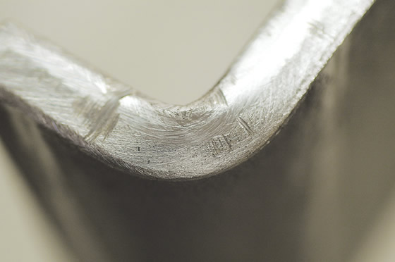

Deep scribe lines can be a failure point when forming. Use a superfine point marker or pencil if the part will be subject to high stress. High-strength materials and tight-radius bends fail along these little stress risers.

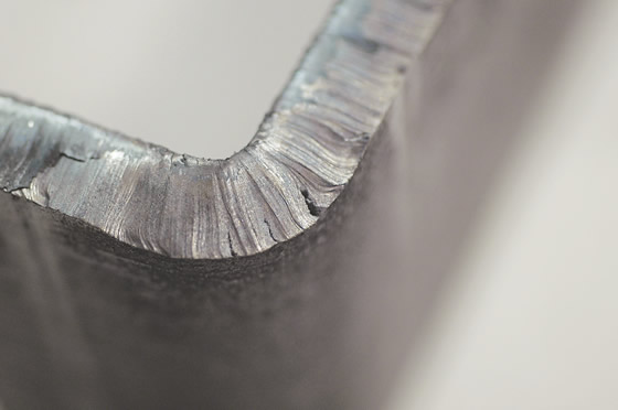

Forming heavy plate sometimes requires the edges to be softened or sanded to eliminate potential crack-starting flaws. For example, it’s a good idea to sand plate edges to remove the ridges left from flame cutting. In addition, slightly round the corners on a plate surface. It’s just good practice on flame- or plasma-cut edges to always skim over them with a sander or grinder to eliminate potential crack-formation points and to remove the hard scale layer that can damage tooling for forming.

Skim over flame- or plasma-cut edges with a sander or grinder to eliminate potential crack-formation points.

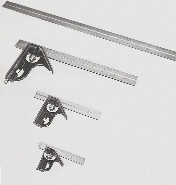

Even for a small amount of layout work, a combination square is mandatory. If you have one of those cast aluminum combination squares, do yourself a favor and throw it away. Better yet, break it into pieces so nobody pulls it out of the trash can, where it belongs. You can judge peoples’ commitment to their profession by the tools they use. If you don’t already have one, get a professional forged and hardened combination square set with an additional long blade. These tools last so long that your grandkids will be using them long after you’re gone. Normally, I use the long blades as straight edges or to set distances off an edge. You have to be careful and have a fine touch when using a long blade to check squareness. I like to have several squares when doing repetitive layouts. All I need to remember is the small square’s small dimension, the medium square’s middle dimension and the big square’s big dimension.

Get a professional forged and hardened combination square set with an additional long blade to ensure long tool life.
