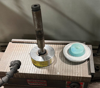

This method of EDMing uses a pre-determined shape of electrode (most made of high-density graphite or copper-tungsten). So long as you can machine the negative geometry of your desired feature and attach it to the toolholder for the machine, you are in business. (See figure 1 for a test part made before burning the shape into a mold body.)

This forced the crop of civil engineering seniors at the time to come up with a new plan. They designed a self-aligning and self-locking mechanism that used a rod of hex stock with a slot in it for a spring-loaded latch. The connector that they welded onto the bridge needed a slightly larger hex pocket cut into it, and, since we didn't have the time to wait for a hex broach nor the means to align it the same way every time (there were 50 of these connectors to make), we decided to buy hex-shaped high-density graphite. We chopped a few pieces off at an arbitrary length, turned the one end down to fit into our toolholders for the machine, and oriented them in the holder such that they could cut the same pocket every time. We were able to set the machine for depth (see figure 3) and continue roughing out more connectors to be burned. The electrode being a perfect hex also meant that the six corners were cut as sharp as possible, barring graphite degradation, meaning the stock could cleanly pass through the pocket. This would have been nigh impossible with most conventional machining methods as the corners would all be rounded.
