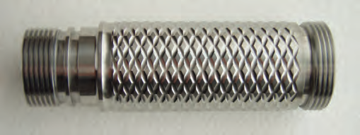

Then, instead of applying a conventional knurling tool to form the knurl pattern into the workpiece surface, Brosius employs an efficient, controllable and repeatable method to knurl the central section of the cell tube. That’s because Goetzen was dissatisfied with the consistency of common knurling techniques.
“It is very difficult to specify an exact knurl pattern, depth and feel,” Goetzen said. “Sometimes it is too sharp, sometimes it’s too smooth, and the depth of the impressions and the width of the diamond shapes can be difficult to control. It can vary from one run of parts to the next, even from the same shop. Beyond looking nice, the body of the flashlight is what you hold in your hand, and how it feels and the grip it provides is really important.”
Goetzen said he experimented with different patterns and depths on ProEngineer Wildfire CAD, and “eventually came up with something that looks great and performs well also.” Five-axis milling with a ball endmill can produce a knurled surface, but that typically creates unwanted deep valleys and sharp corners, he noted. “I wanted something that was a little more aggressive without the typical abrasiveness of a deep knurl,” Goetzen said.
Goetzen and Brosius decided to turn the knurl on the Mazak lathe. “To get the diamonds to the right size and figure out what kind of tooling to use, I started playing around with the threading options offered by the Mazatrol conversational CNC,” Brosius said.
The chosen pattern was a 12-entrance thread with a 1½” pitch. Instead of cutting a single path around the bar, as in a simple screw thread, the toolpaths start at 12 points around the bar circumference. Each toolpath creates a spiral entirely around the part. Twelve threads are cut with a Top Notch 0.125″-wide, full-radius, right-hand grooving insert. Then the lathe spindle is reversed, and a Top Notch left-hand tool cuts 12 threads the other way. The reverse set of spirals on top of the first set produces the diamond-shaped knurl pattern. Each spiral is cut in a single 0.010″-deep pass.
Typical threading speed for an aluminum bar of this diameter would be 300 to 400 sfm, but with the 1½” pitch of the spiral, the tool is “moving pretty quickly” at those speeds, Brosius explained. So, to minimize stress on the machine tool, he slows the cutting speed. “I got the best finish at 100 sfm,” he said, “and it mimicked about 50 percent of the speed of my rapids, kind of an even flow back and forth over the part.”
The Mazatrol software automatically calculates feed rate in relation to pitch and cutting speed. Knurling the longest tube consumes about 44 seconds. “It works beautifully,” Brosius said. “No cleanup pass is necessary.”
The low-force nature of the knurling process enables Brosius to produce the knurl on the three shorter tubes without the use of a tailstock. For the two longer versions, after facing and OD turning the part, he center-drills the bar face and brings in a programmable tailstock for support during knurling.
Brosius noted that the knurl starts and ends in the middle portion of the cell tube. “By doing some calculations and changing the starting points and end points for the thread, I am able to keep that accurate within a couple thousandths.”
TorchLABACTPrtT6-11.tif
Courtesy of ACT
American Concepts and Technologies machined all details of this aluminum cell tube for a TorchLAB high-performance flashlight, including its unique “Diamondback” knurl pattern.
