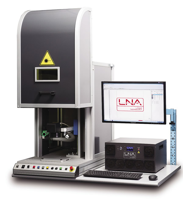

Marking systems, such as this one from LNA Laser Technology, are used to impart precise marks onto even extremely delicate parts. Image courtesy LNA Laser Technology.

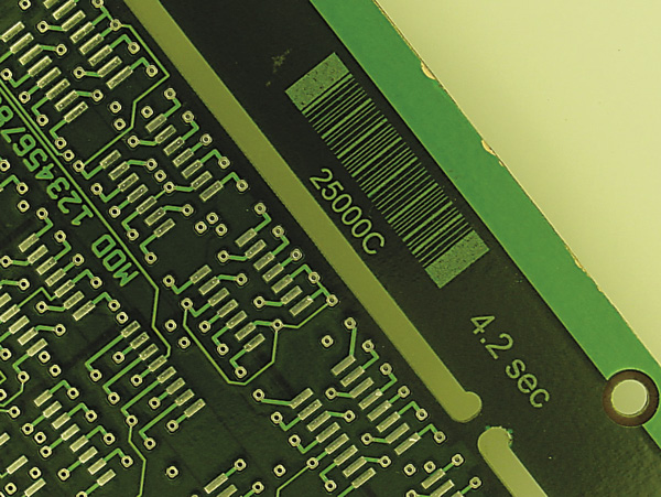

Lasers can be used to mark sensitive electronic devices, such as printed circuit boards. Image courtesy LNA Laser Technology.
