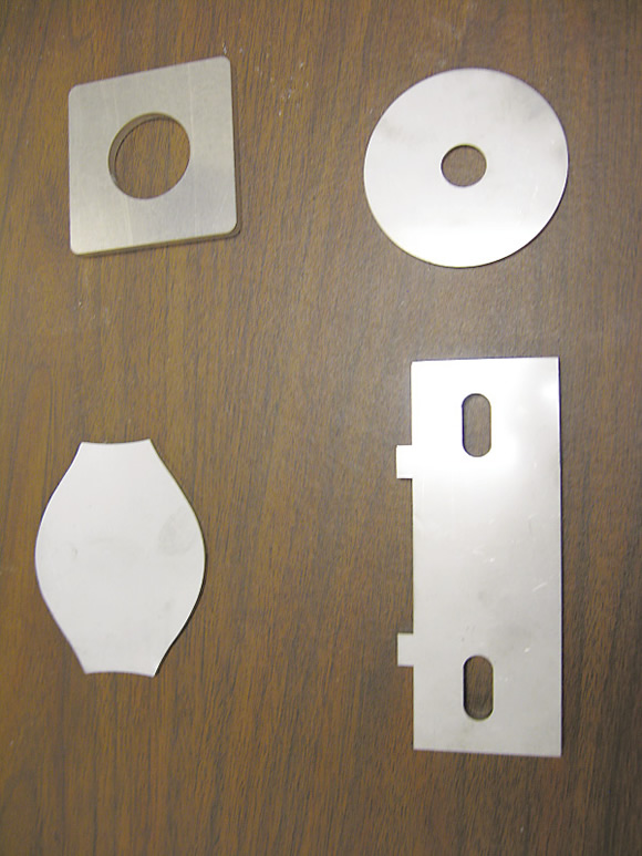

Wagner%20IMG_0015.tif
Courtesy of Wagner
Examples of flanges, made from ¼ ” stainless steel, 11-gauge stainless steel and 3/8 ” aluminum, that Wagner produces with the BySprint fiber optic laser cutter.
“And we don’t have the waste disposal of the spent garnet that we had with the waterjet machine,” he added. “We were sending 65 tons of spent garnet to the landfill every year.”
