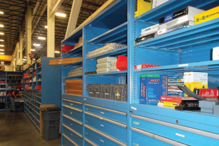

SAM_0137.tif
Courtesy of Savannah Machinery Works
The toolcrib at SMW includes ready access to toolmaker catalogs and technical manuals.
