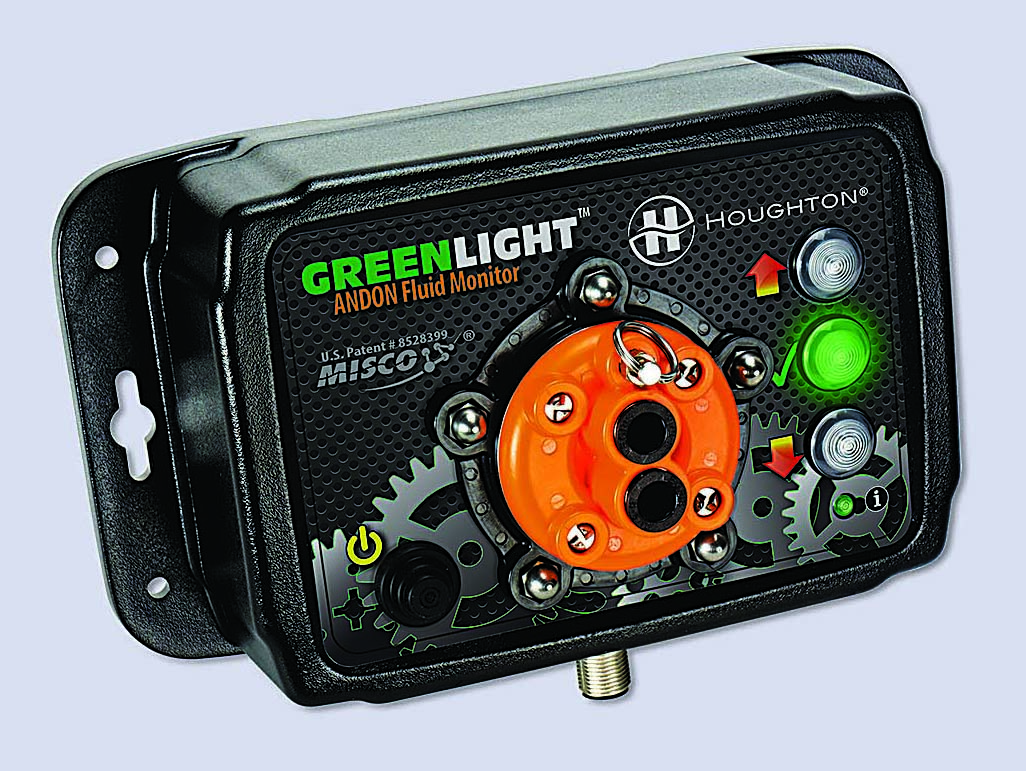

Houghton installed a Greenlight “Andon” fluid monitor on the Mitsubishi MVR 30 bridge mill’s 300-gal. sump. Image courtesy of Houghton International.
Shufelt added that with the new coolant, the concentration remains more consistent. That’s easy to determine on the Mitsubishi bridge mill. Houghton installed a Greenlight “Andon” fluid monitor from its equipment division on the machine’s sump. (According to Houghton, andon is a Japanese term used in lean manufacturing. It refers to a system of alerting workers to a quality or process problem.)
In operation, if the required coolant concentration range is from 6 to 8 percent, the Andon’s center light illuminates green when it’s within that range. However, one of two lights will illuminate yellow if the concentration is slightly out of range, low or high, and one of two of those lights will illuminate red if the concentration is substantially outside the acceptable range.
Now when he enters the shop in the morning, Shufelt sees a green light, he said. “There will be a red light every so often; it was daily with the other coolant, especially during the summer months.”
