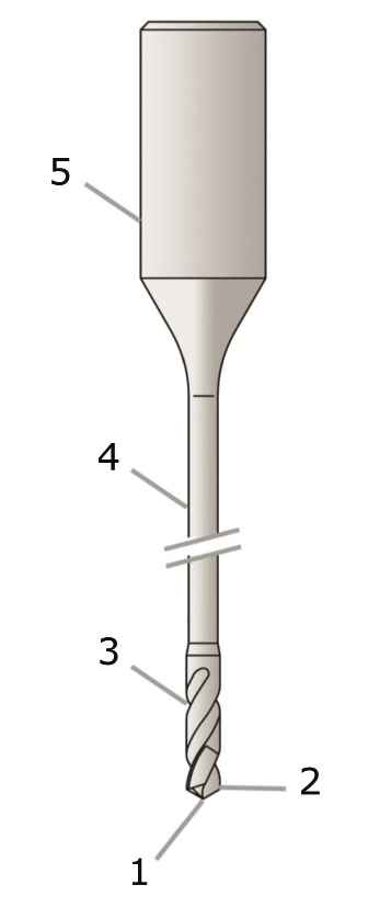

The design of Mikron’s CrazyDrill Flex facilitates drilling to 50× diameter in tough materials.
1. Tip geometry reducesfeed force.
2. Cutting edge preparation inhibits breakage.
3. Flutes create short chips.
4. Flexible neck prevents breakage due to alignment errors.
5. Robust, no-runout, 3mm shank.
Image courtesy Mikron Tool.
