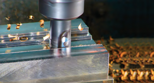

One of the perennial issues in metalworking is the cost of cutting tools. Many tool manufacturers promote low-cost tools or “free” cutters with the purchase of inserts with the idea that their use can save shops money. However, what shops should be asking is: “What is this free cutter actually costing me?” or, “Is this cheap insert really saving me money?”
Initial savings gained by using a free cutter body or a low-cost insert can frequently affect performance by sacrificing tool life or cycle time. Upgrading to a high-performance tool will likely cost more per edge initially—sometimes significantly more. How do you determine if a specific cutting tool is a good value for the shop?

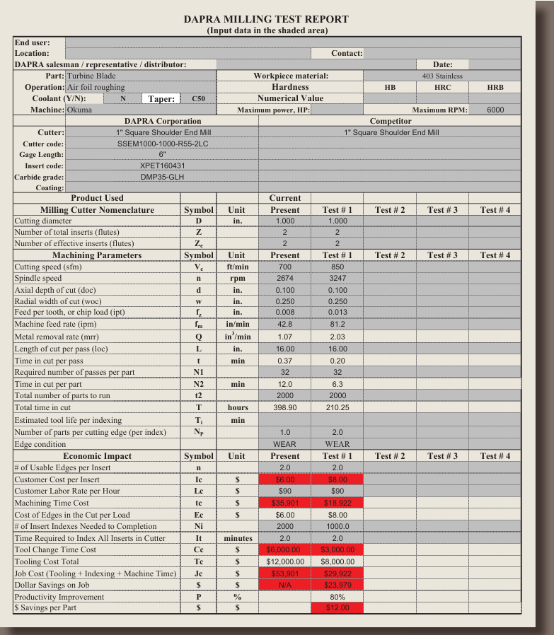

Most cutting tool cost calculators are spreadsheets that measure all pertinent variables in a cutting application. For example, Dapra uses a spreadsheet that includes the metrics outlined in Figure 1. These metrics are often interrelated. The goal of a test report is to measure the variables involved to make an accurate determination of any cost savings.
Figure 1. Variables included in Dapra’s cutting tool cost calculator.

Let’s examine two case histories to see how this works. Test No. 1 (Figure 2) compared two different 90° indexable cutting tools used to machine a turbine blade. The shop was using a 1 “-dia., 2-flute indexable carbide endmill to rough turbine blade airfoil surfaces. Running at 43 ipm, the tool took the required 32 passes to complete the part in 12 minutes. Each insert cost $6. The shop produced 2,000 equivalent parts annually. The 2,000 parts required 2,000 indexes because the edges showed wear after each part, so total tool cost was $12,000 ($6 per insert × 2 inserts per tool ÷ 2 usable edges × 2,000 parts).
The shop needed to stop the machine to index, so the 2 minutes required to index the tool cost the shop $6,000 annually at a $90 hourly labor rate. With a 12-minute cycle time per part, 2,000 parts would take a total of about 400 hours annually to machine. At the $90 hourly labor rate, machining time cost $35,900 annually. Total cost for this operation (tools plus indexing time plus machining time) was $53,900 annually.
The Cost of Cutting - sample test report 1.pdf
Figure 2. 1 ” square shoulder endmill test report.
The shop tested an $8 insert. Many shops would reject an insert that cost 33 percent more without even testing it, but closer examination reveals that the initial cost difference actually turns positive for the shop. The new insert was capable of both higher speeds and increased feeds, nearly doubling the metal-removal rate of the cheaper insert. Consequently, cycle time per part dropped from 12 to a little more than 6 minutes, reducing the annual machining time cost for 2,000 parts to $18,900. The number of parts produced per edge doubled, from one to two.
The new tooling cost was $8,000, because only half as many indexes were required ($8 per insert × 2 inserts per tool ÷ 2 usable edges × 1,000 indexes). As a result indexing cost was reduced by 50 percent, to $3,000 annually. Total machining cost with the new tool in test No. 1 was: $8,000 (tools) + $3,000 (indexing) + $18,900 (machining time) = $29,900. This represented an annual savings of $24,000 and a per-part savings of just under $12 compared to the old tool.

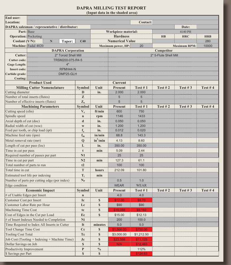

In test No. 2, a shop was purchasing inserts at a high price, but using “free” cutter bodies. The shop was reluctant to consider any cutting tool supplier that would not offer the same deal, but what were the free bodies really costing? In the test report (Figure 3), estimated annual cost for pocketing mold bases was about $23,500, based on insert cost of $12, machining time per part of 2 hours at a $90 hourly labor rate and an indexing frequency of 0.5 parts. The shop agreed to test a new tool.
The Cost of Cutting - sample test report 2.pdf
Figure 3. 2 “, 5-flute shell mill test report.
The mrr of the test tool was double that of the first cutter, reducing cycle time by more than 50 percent and finishing the part with one cutting edge. The test insert cost $9.70, producing an immediate savings. Estimated total annual cost using the tested tool is $11,125, an annual savings of more than $12,000.
But what about the free cutter body? If the shop consumes one cutter per month in this application, at a typical industry price of about $300 for a 2 ” shell mill, annual cutter cost is $3,600. That means the annual cost savings is still more than $7,500.
