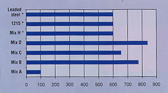

Each material was pressed into a number of pucks 4″ in diameter and 1″ deep. Sixty holes were drilled in each puck in the same pattern. The researchers took chip samples from every 20th hole that was drilled. Each test was continued until the drill failed or the pucks prepared from the material were consumed. The drilling conditions were held constant for all seven mixes. The conditions were chosen to reflect typical drilling practices in the field. The drill material was HSS with a black-oxide coating. Each drill was ground with a standard 118° included angle and a diameter of ¼”. The researchers ensured the accuracy of the test by choosing intermediate speeds and feed rates. The rotational speed was 2220 rpm, the cutting speed was 145.3 sfm, and the feed rate was 0.005 ipr (11.1 ipm). No cutting fluid was used because the researchers feared that, by improving machinability, the use of cutting fluid would interfere with the results. Following the drilling tests, the researchers examined the first chip sample along with the 40th hole in each puck. To examine the chips under a light optical microscope and a stereomicroscope, the researchers mounted the specimens, ground and polished them, and then etched them in 4% Picral for 90 seconds. Machinability Varied |
| Figure 1: Number of holes drilled before failure. (*Only 600 holes were drilled because that was all the material that was available.) |
As an alternative to tool wear, the researchers considered the torque and thrust measurements that were taken during the drilling test (Table 3). High torque and thrust seem to indicate poor machinability, since the tool is working harder to cut the material. When they looked at the torque and thrust data for the three materials that did not cause the drill to fail, they saw that Mix H had the best numbers. They then compared the data from Mix H to the data from Mix D and found that the drilling test with Mix D yielded even better torque and thrust than Mix H. The variation in torque and thrust for Mix D indicated that the material could have been machined for much longer than Mix H before the drill failed. From this data, the researchers concluded that Mix D had the best machinability.

The researchers concluded that machinability can be improved by the use of additives such as MnS as well as by changes in the microstructure similar to that of Mix D. The test results show that both Mix D and Mix H have machinability that is very close to wrought steel. Further study will prove that PM materials can have similar or better machinability than their wrought counterparts. About the Authors The authors thank Amy Graham and A. Davall of Hoeganaes Corp. The authors also thank Arlan O. Benscoter for all his help with the metallography and his practical wisdom and Kathleen Repa for all her help with scanning electron microscopy. |
