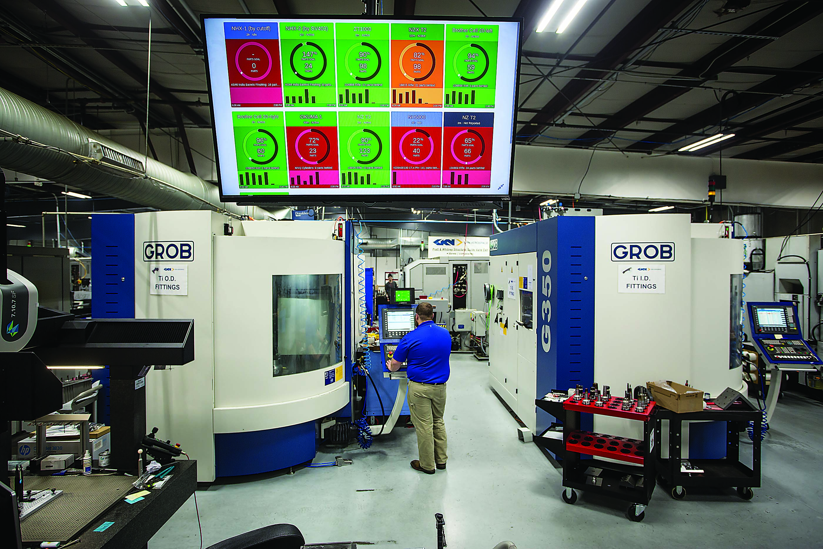

In 2016, Fastenal invested in a machine monitoring system to track everything that happens on a CNC machine and make the most pertinent of the information visible and easily accessible by stakeholders, from the operator on up.
MachineMetrics monitoring system in use at Fastenal's Winona, Minn., facility. Image courtesy of MachineMetrics.
That system, called Machine-Metrics, acts as a historian for machine data, with the ability to export all of a machine's event history for any period of time. The timeline is useful for analyzing what happened and when on a machine, according to Graham Immerman, director of marketing at MachineMetrics, Northampton, Mass.
Information, including machine status, faults, programs, part cycles and job runs, is displayed on the machine timeline. Users can view the status of all their machines or drill down into a single machine for a detailed view. A report is issued that provides statistical analysis of part cycles, often uncovering part-cycle times that were potentially

Fastenal Manufacturing Engineer Matthew Nelson said, "We started out using MachineMetrics to monitor 11 Swiss machines and three twin-turret machines. We installed the monitors on our shop floors so that everyone on the floor can know what's going on—operators and managers."

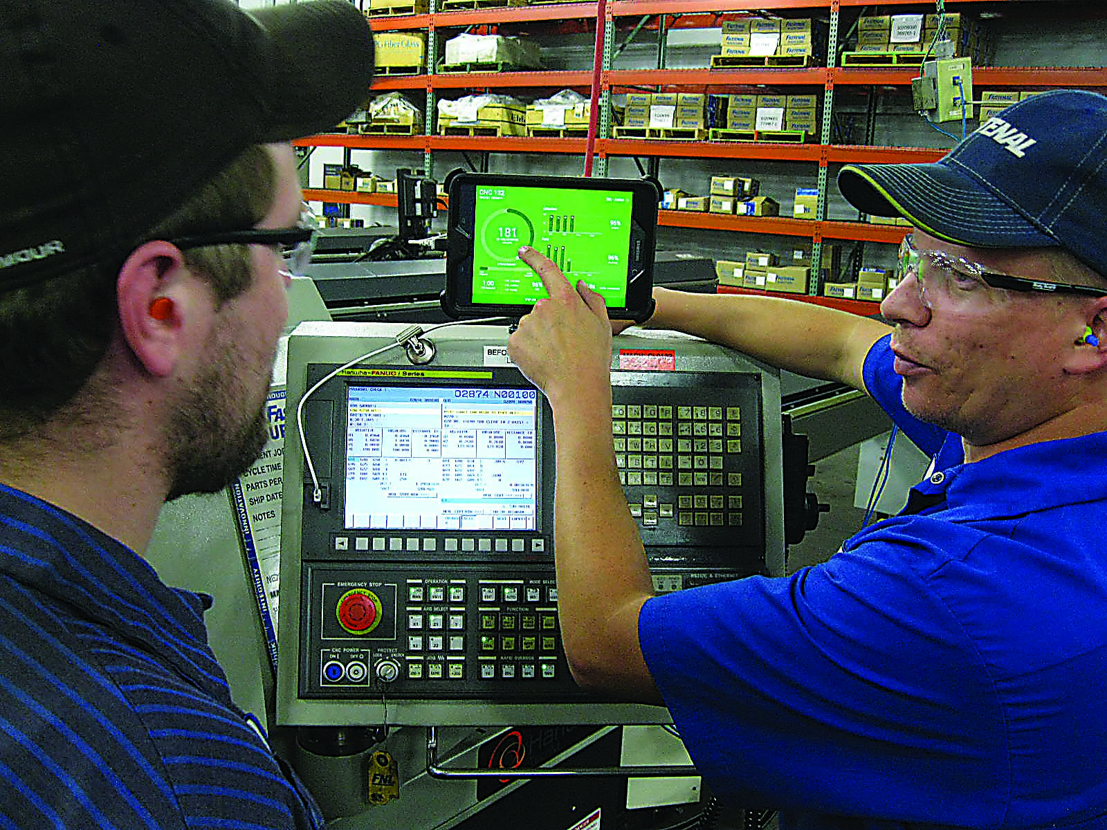

Nelson said he did a lot of the machine-operator training for the new system, and while there was some initial grumbling, the operators have come around.
"The operators had a gut reaction that was, 'Oh, great, now you are looking over my shoulder even more.' But the truth is, if there's something going on, this system gives them more opportunity to be involved in solving that problem." Operators and managers can look at historical data and implement future improvements. "Now, when we have an issue with a job, we can apply what we've learned from this mistake to the next time. We no longer have to be reactive."
