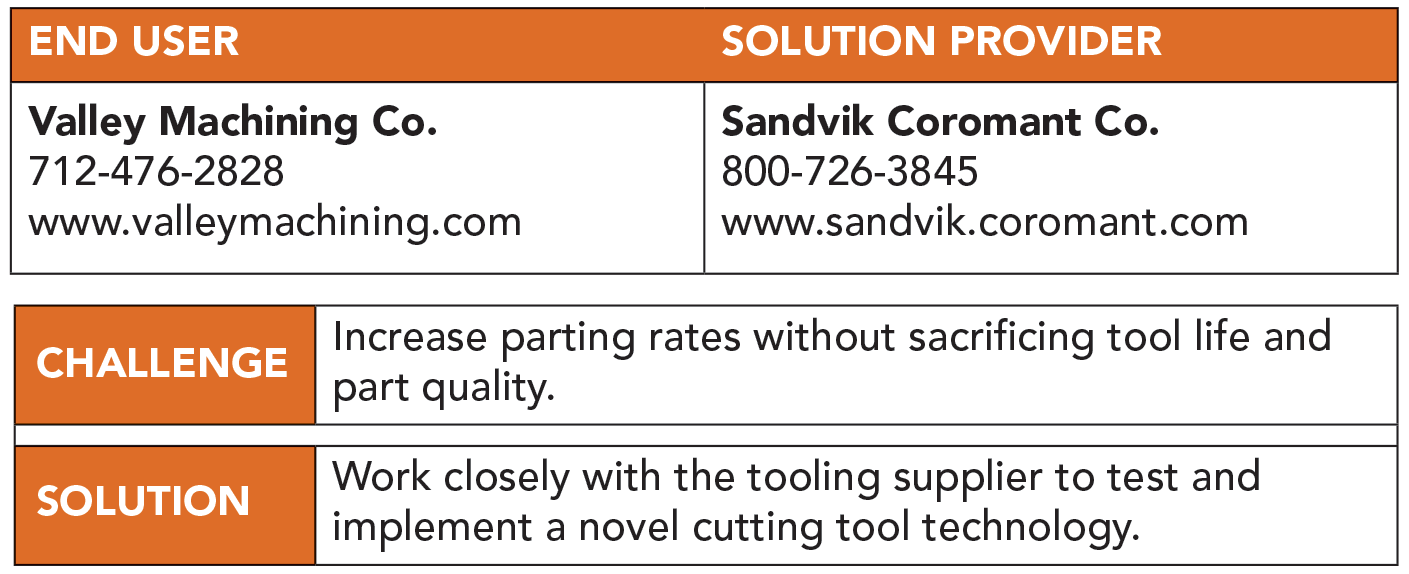

Whether baking a soufflé or trying to beat a red light, timing is everything. So when Brent Schelske, process improvement engineer at Valley Machining Co., Rock Valley, Iowa, stumbled across an advertisement on the Fair Lawn, New Jersey-based Sandvik Coromant Co.'s website for a new kind of parting tool, he immediately contacted the company.

Days after Schelske viewed the video, he and Tooling Engineer Lyle Schneider headed to the shop floor to work with the parting blade. They encountered a few hurdles, however. The lathe was a Doosan Puma TT2500SY with a 3″ bar capacity, an LNS Sprint 12′ bar feeder and a 1,000-psi MP Systems high-pressure coolant unit—one of two such machines at VMC. Schelske removed his old cutoff blade and mounted the new one in an extended-length WTO tool block. But he realized he would have to modify the arrangement to utilize the through-the-tool coolant, a must for the parting tool to be applied at anywhere near the advertised feed rates.
Although that problem was not a big deal, another problem was almost disastrous.
“We did some light parting to test things out,” Schelske said. “And then I said, ‘OK, everything looks good. Let’s give it a whirl.’ The second I hit cycle start, the blade slammed into the workpiece at 3,000 rpm. I’d forgotten that with G96 constant surface speed engaged, the control is normally looking at the X-axis position to calculate the correct rpm value. But with Y-axis parting, the tool is positioned on the X-axis centerline, so of course it shot up to the maximum rpm.”

Fortunately, the tool survived. Schelske then tried programming the cutoff operation in multiple steps, gradually increasing the rpm as the Y-axis approached center. Results were not satisfactory. After searching the machine manual for a parameter that would tell the control to recognize the Y-axis rather than the X-axis for rpm calculations, he called his machine distributor for help.
“The guy didn’t get it at first,” Schelske said. “‘Why on earth would you want to do that?’ he asked. I wasn’t sure how to explain it, so I sent him the link to the Y-axis video. He did some digging and found the correct value to change. After that, it was seamless.”
In low-carbon steel, such as 12L14 and cold-drawn (CD) 1018, the CoroCut QD achieves a feed rate of 0.016 ipr at 600 sfm. In 4140 alloy steel, the tool is routinely fed at 0.012 ipr and 500 sfm. By comparison, Schelske typically ran his old cutoff tool at only 0.004 to 0.005 ipr at 400 sfm, depending on the material.
“I used the mean spindle speed in relation to the feed rate when determining rough estimates for the gains we’ve made,” Schelske said. “With low-carbon steels, we’re hovering around a 500 to 600 percent improvement. Resulfurized steels, such as CD 1144, see a 300 to 400 percent gain. And we’re in the same ballpark with A36 structural steel. The smallest gain we’ve seen ranges from 200 to 300 percent, and that’s with CD 1045 material.”
