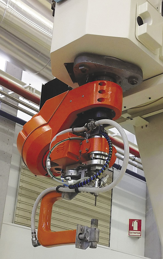

In addition to a head for milling, drilling and routing, Flow Aerospace’s Composite Machining Center has a 5-axis waterjet head with an arm that functions as a 6th axis and holds a cup to catch the water, abrasive and material from the part.

Flow Aerospace LLC also offers a gantry-type machine for cutting composites, but with a twist. Chief Engineer Mark Saberton explained that its Composite Machining Center has two vertical masts on the gantry: One mast has a 5-axis drilling and routing head and the other has a 5-axis waterjet head with an arm that functions as a 6th axis and holds a cup to catch the water, abrasive and material from the part.
The captured material is evacuated through the machine and into a system that separates the water, which goes down the drain, from the solids, which are nonhazardous and deposited in a 55-gal. drum for disposal. The Jeffersonville, Ind., machine builder is part of the Ascent Integration & Automation Group of Ascent Aerospace, a wholly owned unit of AIP Aerospace, Santa Ana, Calif.

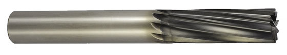

Machining composites tends to generate a different type of chip than the metallic variety, one that resembles dust. Some people call them chips but they’re really tiny particles comprised of carbon and epoxy, Saberton said, adding that grain size varies along with the workpiece.
On the other hand, Tom Cornwell, sales and application specialist for LMT Onsrud LP, described the composite chips as microscopic “sixes” and “nines,” even if they appear to be a fine powder. The Waukegan, Ill., company makes cutting tools for machining advanced materials, such as the 66-700 series of diamond film-coated, low-helix tools for tackling abrasive composites.
“They will look like chips if everything is done right,” Cornwell said, noting that’s the case for the fibrous material and the resin, which holds the structure together. “It won’t be dust, it’ll be chips, and you can carry the heat away with the chips. That keeps the tool and the part cooler. The benefits are increased tool life and protection against the risk of part delamination.”
He added that the machining process is more like grinding than cutting, because of the smaller size of the chips.
66-715%20Series%2066-700%20UC%20CBG%20150.tif
Courtesy of LMT Onsrud
LMT Onsrud offers cutting tools for machining carbon fiber-reinforced composites, such as the 66-700 series, with a low-helix flute angle to reduce vibration. According to the company, the open flute geometry dissipates heat to prevent resin flow.
Saberton concurred that the process is similar to grinding, where the tool fractures the workpiece, compared to the shearing action seen when machining metal. “Everybody tries to draw an analogy between machining metals and machining composites and there’s no correlation between the two whatsoever,” he emphasized. “If you try to shear a composite, you rip it to pieces.”

Dust isn’t an issue when waterjetting composites on the Composite Machining Center, Saberton said. When milling and drilling, however, dust is a major problem, so the machine generates a cold air mist around the cutting tool to cool the tool and form a plume around it.
The dust gets caught in the plume before it has a chance to become airborne and falls down on the part, Saberton noted. The part is then hosed off, the dust goes into a pit underneath the machine and is processed through the filtering system that handles the waterjet waste. “There is no risk to the machine and no risk to people,” he said.

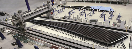

The Composite Machining Center from Flow Aerospace is a gantry-type machine for producing large composite structures, such as this airplane wing skin.
Even machining different composite materials in the same machine can be problematic. That’s because an element, such as Teflon, in one type of composite can interfere with the bonding surface of another. “A lot of the space programs don’t want any Teflon around their parts, so we thoroughly clean the coolant systems between projects,” said Janicki’s Kooda.
Because aerospace composite structures can be quite large, the machining center for cutting them must be highly accurate and reliable, as well as large. For instance, Janicki builds machines with a 100 ‘×20’×8’ (30.5m × 6.1m × 2.4m) milling envelope, Kooda said.
“Some of the programs we work on require a 0.003″ hole position over 100′,” he said. “If something happens during the machining process, you cannot just go grab another part from the shelf or order another one. The parts are so expensive, it really has to be done right the first time, every time. That philosophy goes into the machine design as well.”

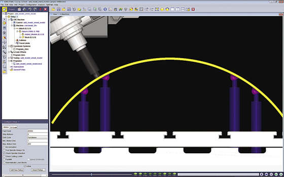

Because composite workpieces have a significant amount of process time and labor in them prior to machining, they can be more expensive than even some exotic metal alloy workpieces, according to Bill Hasenjaeger. The product marketing manager for VERICUT machining simulation software developer CGTech, Irvine, Calif., added that it’s not possible to repair a composite workpiece damaged during machining. “Thus, validation of the part program is extremely critical.”
Pogo-fixture-VERICUT.tif
Courtesy of CGTech
When machining thin cross-section composite parts, it’s critical to accurately simulate cutting operations to avoid damaging a “pogo” fixture, which can ruin the fixturing device and cutting tool or cause the workpiece to become loose and suffer damage.
That includes accurately emulating CNC logic and detecting collisions and near misses between the cutting tool and all machine tool components, including axis slides, heads, turrets, rotary tables, spindles, toolchangers, fixtures, workpieces and other user-defined objects.
Composite parts are often found in mission-critical applications, such as aerospace. Typically, an ultrasonic knife or waterjet cuts thin cross sections, such as airframe skins and structural frames and stringers, Hasenjaeger said. He added that simulating these cutting processes requires software that emulates the cutting behavior to detect improper conditions.
In addition, the software must generate accurate material-removal models to compute the cutter contact patch for every cut and avoid melting or burning the heat-sensitive workpiece material. Hasenjaeger noted the appropriate simulation package sets cutting parameter limits and identifies where they are exceeded.
The modifications to machine tools for cutting composites that impact the collision-checking process generally involve vacuum equipment and other hardware used to evacuate dust, Hasenjaeger said. However, the fixtures for cutting thin composite parts can be more complex and costly than ones for other types of machining operations.
Avoiding a tool collision with a workholding device is always important, but avoidance takes on an added dimension when machining these slender workpieces. For example, when using a vacuum fixture, cutting into the fixture beyond a certain depth will break the vacuum, ruin the fixture and set the workpiece free, likely ruining it, Hasenjaeger explained.
He added that another workholding method for these types of parts incorporates “pogos,” individually positioned supports located under a workpiece and with vacuum cups on the ends. “Cutting into a pogo can ruin it and the cutting tool,” Hasenjaeger said, “or cause the workpiece to come loose and ruin it as well.”
