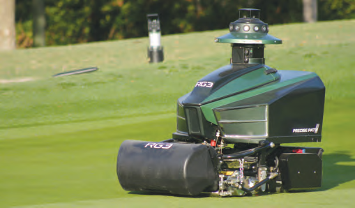

One out-of-the-ordinary project evolved from prototype work to production. Rayco machines more than half the components for the RG3 robotic greens mower from Precise Path Robotics, which is engineered to boost golf course labor productivity.
A typical part is a roller drive rear spindle. More than 3 ” long with a major diameter less than 3 “, the part is machined from 3 “-dia. 4140 steel bar prehardened to 28 to 32 HRC and sawed to 3.560 ” lengths.

Among the parts that Rayco Machine & Engineering Group machines for the Precise Path RG3 robotic greens mower is this steel roller drive rear spindle (above). Below: The Precise Path RG3 robotic greens mower, with a guidance beacon in the background.
