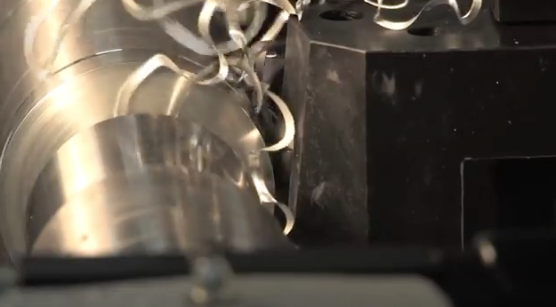

To machine the rings, the turning center is fitted with both turning and rotating synthetic-diamond brazed tooling. Cycle times average 45 seconds for OD and ID machining and 25 seconds to cut the ring off the tube.

Tungsten Pride machines tungsten-carbide tubing on a CNC turning center for custom wedding, engagement and personal rings.
Craig Brosius, Tim’s son and Tungsten Pride president, said special workholders provide the rigidity required to produce fine details in the rings, and it is important to apply sharp tools to minimize cutting pressure. However, most other details of the process remain trade secrets.
