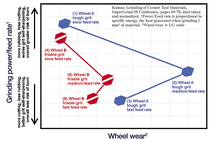

Figure 1. Data from a test of two wheels grinding cermets at three different feed rates.
Figure 1. Data from a test of two wheels grinding cermets at three different feed rates. Chart
courtesy J.Badger.

The figure shows data from a test of two wheels grinding cermets at three different feed rates. Which wheel and feed worked best? It depends. If you want a long-lasting wheel, go with wheel B at a slow feed rate (4). If you don’t want burn, go with wheel A at a fast feed rate (3) or wheel B at a fast feed rate (6). If you want some combination of long wheel life, low burn and short cycle time, go with (6), (5) or (3).

It’s safe to say that, overall, B is the better wheel. But run it at a slow feed and you’re going to get burn. I’d take wheel A applied at a high feed (3) instead of either wheel B, option (5) or (4).

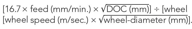

If you have some influence over testing parameters, first calculate the superwheel’s aggressiveness number for the customer who experienced success. Here is the equation for determining an aggressiveness number:
The madness of wheel trials
Your superwheel wants to be run at something close to this aggressiveness number.
Then, when you visit customers, tell them to run any DOC and feed rate they like, but run at the wheel speed that gives the aggressiveness number you calculated.
I can’t guarantee it will always work, because there are other factors involved, such as coolant application, carbide grade and coolant-additive chemistries. But if you start with this aggressiveness number for the superwheel, you’ll increase the chances of it succeeding.
