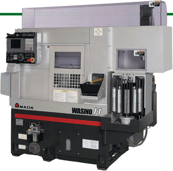

Based on an Amada Wasino-developed time study and process, Progressive Machinery Inc., Amada’s Milwaukee-based Wisconsin distributor, proposed an automated solution. NORAM evaluated purchasing the J1 turret-type turning center with integrated part autoloader and rotary part supply device from Amada Machine Tools America Inc., Rolling Meadows, Ill. Initially, the equipment appeared to have an unacceptable return on investment determined by the projected cycle time reduction for the highest-volume job. “It did not meet our 1-year payback criteria,” said Guy Campbell, the company’s manufacturing engineer and quality manager. NORAM had found a similar scenario when evaluating other automation equipment. “My average lot size of 25 pieces meant that the additional setup time for the automated cell was larger than the labor savings when the jobs ran,” he said.

NORAM purchased an Amada J1 turret-type turning center with a turntable to stage parts and a part load/unload mechanism to lower manufacturing costs.
As part of the turnkey project, Amada developed a part-specific jaw configuration for clamping directly on the part. This increased clamping stiffness and allowed machining at higher speeds and feeds, according to Campbell. In addition, Amada specified polycrystalline cubic boron nitride inserts from Shape-Master Tool Co. for use on the machine.
NORAM integrated the Amada machine into a work cell run by one operator that includes another lathe and two VMCs.
The switch to the automated lathe reduced cycle time for boring from 3.74 minutes to 33 seconds, and tool life averages 7,500 pieces per corner. Total labor per piece went from 0.064 hours to 0.016 hours, and the production rate for the cell went from 30 pieces per hour to 110—10 percent more than forecast.
In addition, the new machine’s enhanced capability enables NORAM to bore the parts prior to heat treating and eliminate the bore precoat cleaning, coating and coating-removal processes. “Even with variation that’s added by the heat-treat process, I still end up with better parts than before we got the Amada,” Campbell said.
“Once the part is heat treated, it is done,” Hargarten added. “It doesn’t have to be touched after that. We didn’t even anticipate that when we bought the machine.”
The J1 turning center takes 6 to 8 hours to set up vs. an hour to an hour and a half for a typical job on a CNC machine, but Hargarten noted that is currently not an issue because the Amada machine was only purchased and is only used to produce one specific parts family. Running additional jobs on the machine would require investing in new end-of-arm tooling for the pick-and-place robot, and most of the parts NORAM produces are too large for the machine. As it turns out, what used to require a month to produce, the automated machine does in 2 days. That means the machine sits idle most of the time.
Nonetheless, the J1 turning center is well on its way to realizing NORAM’s desired ROI. “A 9-month payback wouldn’t surprise me,” Hargarten said.
