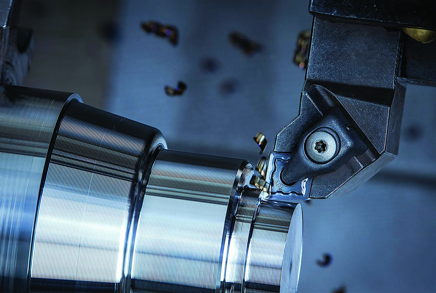

As workpiece materials and machining operations have become more complex, so have the tools and coatings to boost metalcutting productivity for manufacturers.
As workpiece materials and machining operations have become more complex, so have the tools and coatings to boost metalcutting productivity for manufacturers. Image courtesy of Ceratizit USA

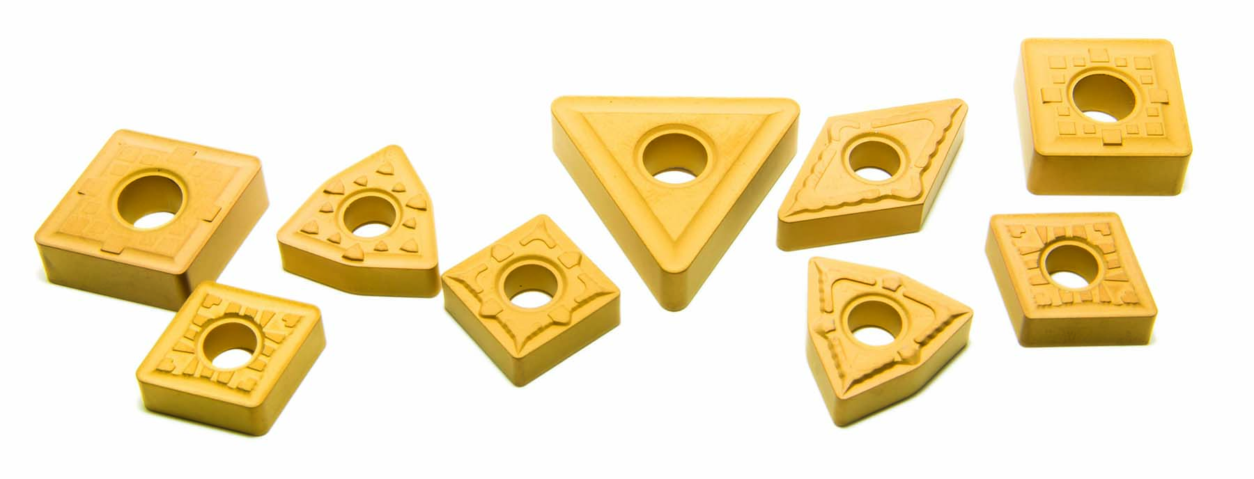

A selection of G5125+ inserts is shown.
A selection of G5125+ inserts is shown. Image courtesy of Greenleaf

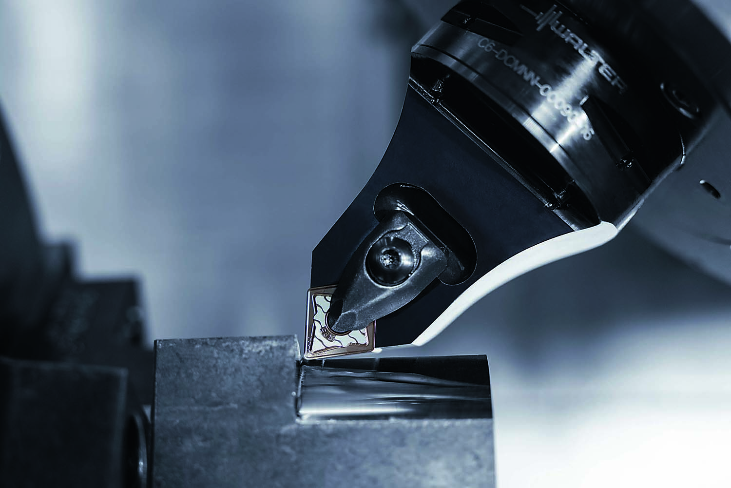

A CNMG insert turns a steel part.
A CNMG insert turns a steel part. Image courtesy of Walter USA

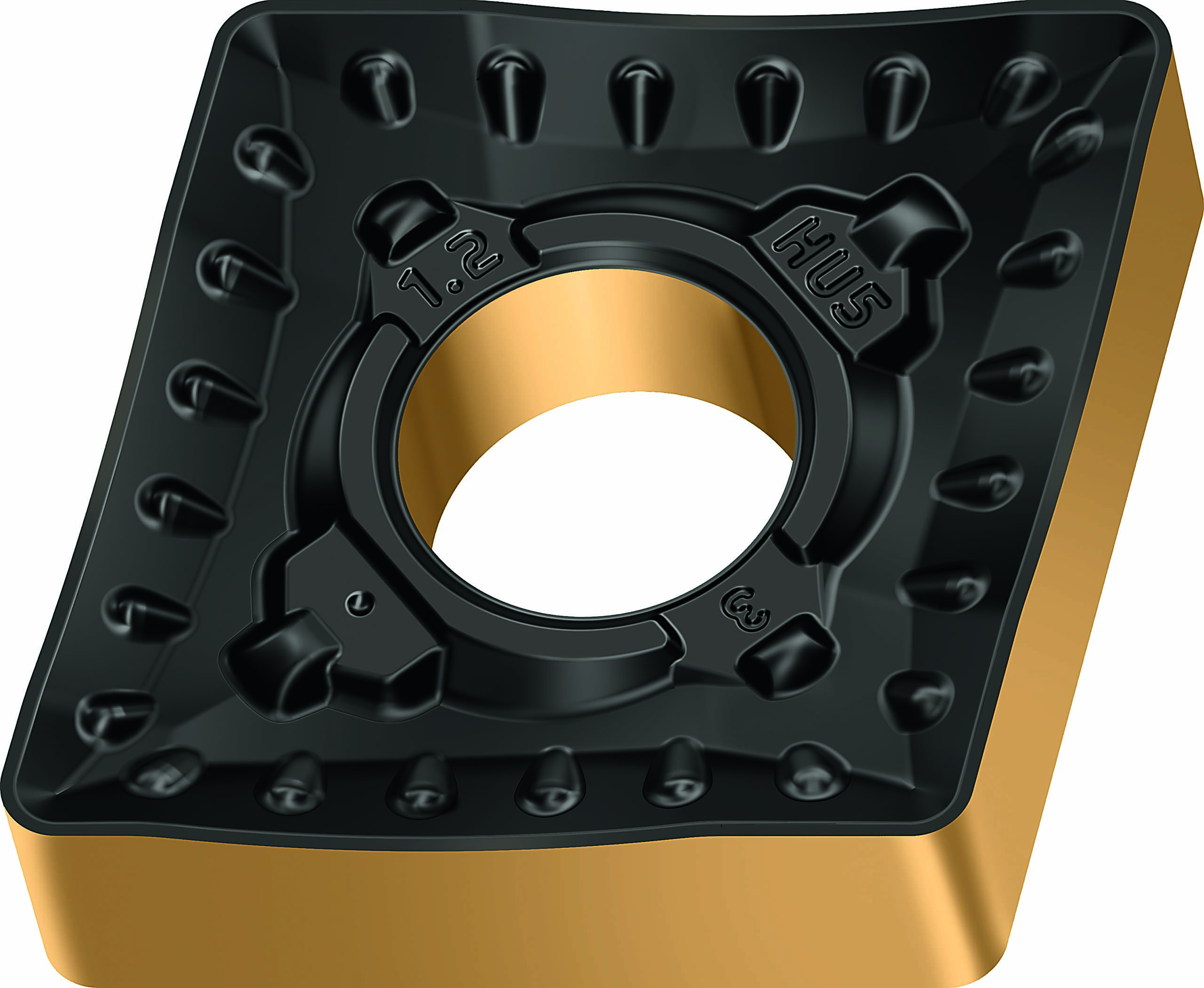

The HU5 is a single-sided, heavy-duty roughing geometry that also has a sharp, positive rake angle.
The HU5 is a single-sided, heavy-duty roughing geometry that also has a sharp, positive rake angle. Image courtesy of Walter USA

In addition, Garud said HU5 is a single-sided, heavy-duty roughing geometry that also has a sharp, positive rake angle.
"This makes it a 'low cutting pressure' geometry ideal for both stainless steels and steels," he said.
