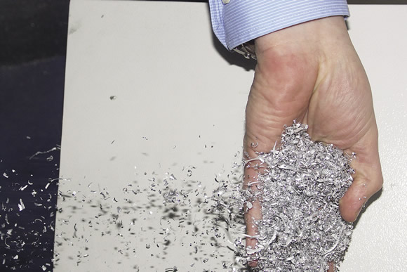

Michael Knauf, head of tool planning (left), Matthias Haug, sales manager for lubrication technology at bielomatik (center), and Bernd Gasch, foreman responsible for cylinder head production, stand at a conveyor where dry swarf (inset) is transported.
