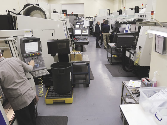

When Dan Doiron took the job of lead CNC programmer at Micron Products Inc., it didn’t take him long to conclude that the company’s sophisticated template-based manufacturing processes could be improved with a more flexible CAM system. However, being a newcomer, he was reluctant to argue against what was already working. Instead, he bided his time.
Micron%201.tif
All images courtesy Micron Products
In the past 5 years, the amount of advanced CNC equipment in Micron Product’s orthopedic machining work cell has doubled while the number of programmer/machinists has remained about the same due to the use of more efficient advanced CAM technology.

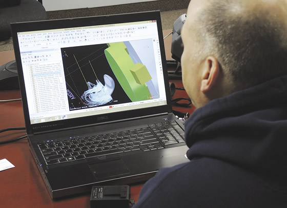

Programmer/machinist Dan Doiron uses Mastercam’s backplot simulation on every implant to ascertain that CNC toolpaths will not encounter interference.
“With the previous CAM software, it took about 45 minutes to produce a CNC program from the template,” Doiron said. “Now it takes less than a third of the time using Mastercam.” The CAD model is imported from SolidWorks and regenerates the toolpaths based on the template.

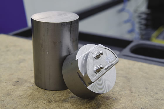

This partially machined knee tibia tray is made of cobalt chrome.
The other part of the solution was using Mastercam’s Dynamic Motion feature to machine even extremely hard cobalt chrome (approximately 47 HRC) at high surface speeds (working up or down from 300 sfm to find the “sweet spot” that results in optimal material removal and tool life).
Dynamic Motion analyzes the part model to create efficient toolpaths that use as much flute length as possible, but with small step-overs. This intelligence also continually adjusts the tool trajectory throughout the operation based on the material conditions ahead of the tool, which guarantees consistent tool/material engagement. The result is high material-removal rates in keeping with the optimal chip load (based on the tool manufacturer’s recommendations) and cutting forces distributed evenly over the full tool length for increased tool life.
“It is particularly advantageous for roughing,” Doiron said. “The traditional way I was taught was to step down progressively, 0.025 ” at a time, until you get to the bottom of the pocket. In this stuff, you cannot do that because the cutter will not last more than two passes before it is blown out. It just kills the corners and you are not going to get any tool life at all. So you need the fullest possible engagement of the flute length. Dynamic is always my first option. Without it, we would be making about three parts per tool with it, but we are getting many times more.”

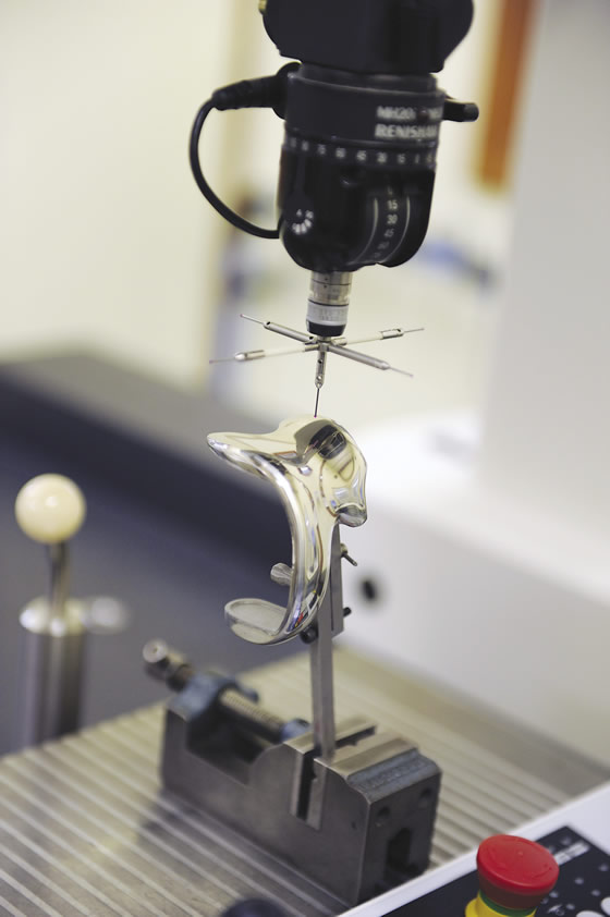

A patient-specific femoral implant made from cobalt-chrome bar stock undergoing final inspection.
