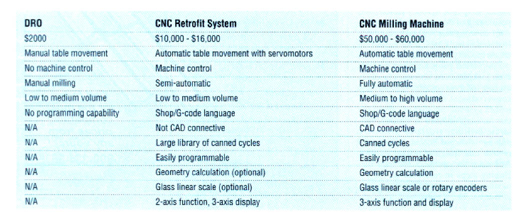

Considering the Alternatives
Manual Mills Get CNC Makeovers
Table 1: A side-by-side comparison of the features of a DRO, a CNC retrofit system, and a CNC milling machine.
If you need to stretch the productive capacity of your manual milling machine, upgrading it with a CNC retrofit package isn’t your only option. You can continue to use the old machine as-is, upgrade to a DRO, buy a new manual milling machine for $6000 to $10,000, or buy a higher volume CNC milling machine for $50,000 to $60,000 (Table 1). You have to do a cost-benefit analysis to see if your productivity gains outweigh your costs. Shops that have purchased CNC retrofit packages have reported a three- to six-month return on their investment.
Your final choice should be predicated on your immediate and future capacity needs, economics, budget, profitability, part volume and complexity, customer relations, and operator skill level. Use the selection questions systematically to arrive at a short list of potential systems. Get vendors involved from the get-go, and then conduct a thorough investigation of the finalists. It’s worth it.
