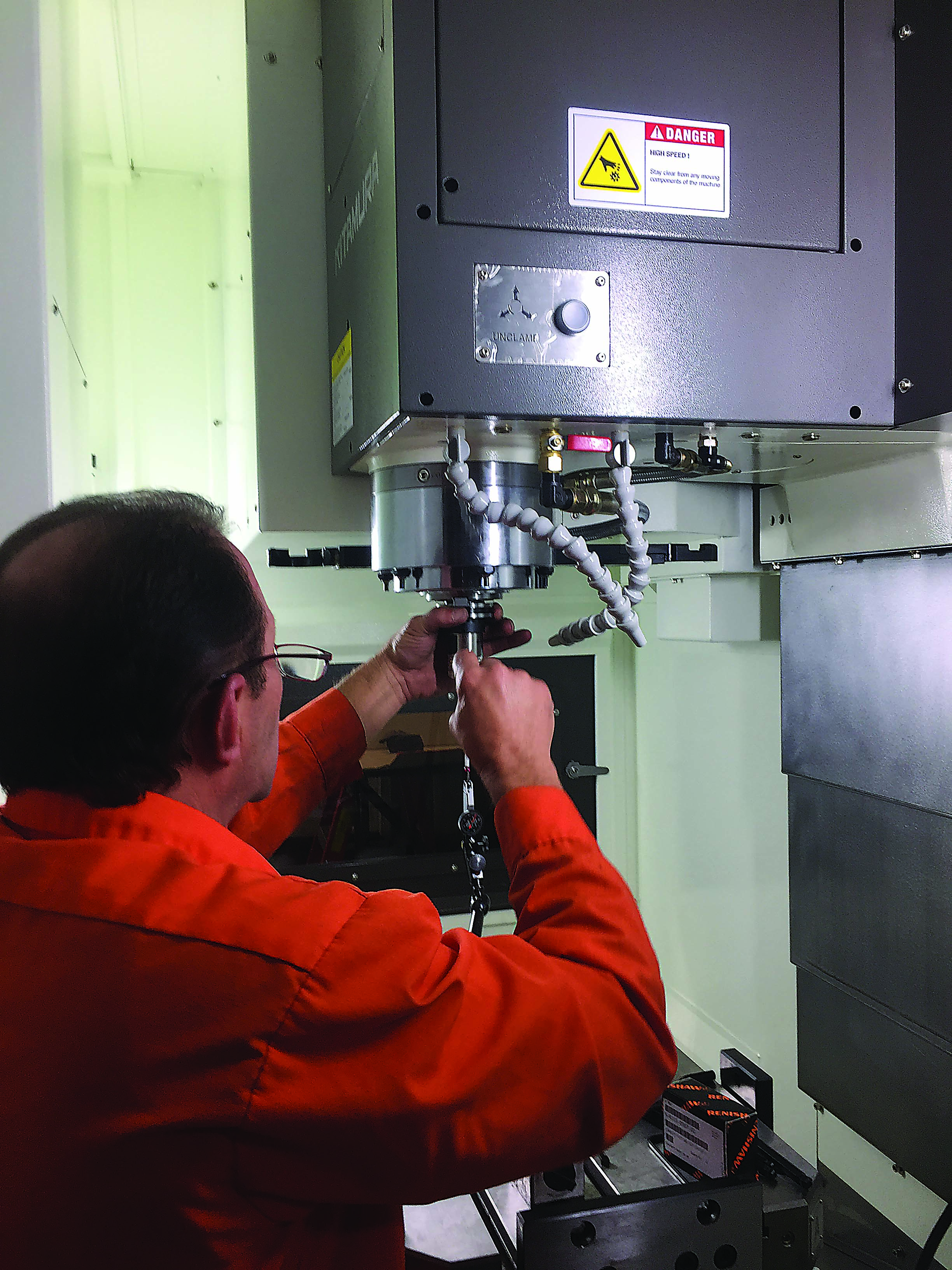

A Knox Machinery service engineer calibrates a probe. Image courtesy of Know Machinery.
