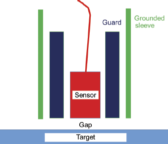

Figure 2. A capacitance sensor with a guard circuit.

The charge builds between the probe and any other nearby conductor, so an additional modification is made for a probe to measure capacitance in the direction it is pointed. First, the sensing element is surrounded by a guard element. Typically, this is a cylindrical sleeve that wraps around the sensor. The guard element is maintained at the same voltage as the sensing element, so there is no built-up charge between the sensor and the guard sleeve. Effectively, this “directs,” or focuses, the capacitance sensing out the front of the probe toward the target. Next, the sensor is surrounded by and electrically insulated from a grounded sleeve. This allows the probe to be handled and mounted without impacting the measurement.
