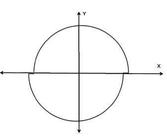

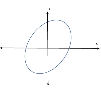

If backlash occurs, as it might with a worn ballscrew or loss of ball nut preload, there is a delay in the portion of the motion where the axis reversal occurs. The resulting plot shows a circle that appears split and shifted (Figure 2). If the moving axes are not square to each other, the ball bar measurement looks like an ellipse (Figure 3). The orientation of the ellipse that results from nonsquareness does not change when the machine is commanded to traverse the circle in a clockwise or counterclockwise direction.

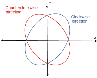

The ball bar measurement also looks like an ellipse if there is a scale error between the axes. But, in that case, the orientation of long axis of the ellipse shifts 90° (Figure 4), depending on whether the circle is traversed in the clockwise or counterclockwise direction.

Figure 2. An idealized telescoping ball bar measurement shows backlash.
Courtesy of S. Smith
Figure 3. An idealized telescoping ball bar measurement shows nonsquareness of the axes.
Figure 4. An idealized telescoping ball bar measurement shows scale error between the axes.
