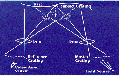

Moire encodes small changes in depth on the part surface into a larger 2-D pattern that can be interpreted by a video-based system (Figure 2). A diagram of a simple projection moire system is shown in Figure 3. The master grating and reference grating are typically the same pattern; both are created by printing, photographing, or etching a series of lines on glass. The master grating is projected through a lens onto the part surface. The pattern formed by the lines of light as they strike the part is called the subject grating. This pattern is viewed through a second lens and a reference grating at an angle different from the illumination angle.

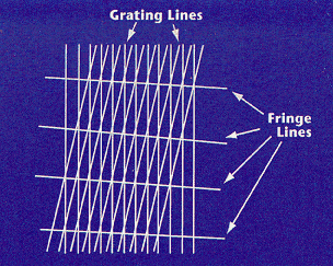

By viewing the resulting image through the reference grating, the video-based system overlays the reference grating and the subject grating. Assuming that the reference grating is made up of straight lines, overlaying the two grating images produces a pattern of light and dark areas called fringes (Figure 4). The fringes form a contour map of the part’s surface in the same way that a topographic map delineates the contours of the land.

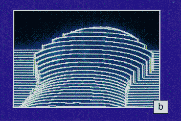

As an illustration of the pattern produced, Figure 5 shows the moire pattern of a soap bottle, along with the 3-D map that was created using data interpreted from the fringes. For this example, a grating was placed in front of the bottle and simply shadowed onto it; then the shadow was viewed through the original grating at an angle different from the angle of the light shining through the grating. This shadow moire effect can often be seen in everyday situations, such as the pattern seen when an object is viewed through a screen door.
Measuring with Moire Figure 1. Moire contouring is based on the principle of structured lighting.

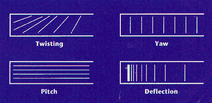

The visual interpretation of moire contouring is simple. Each fringe follows the part surface at a constant depth range from the video-based system. This means that every point along a fringe is at the same depth. A tilt in the part surface will produce evenly spaced lines, whereas a bend or twist will show up as variable spacing. The types of changes in the fringes produced by different surface slopes are illustrated in Figure 6. Because the fringes are a function of the surface’s shape, the moire pattern will look the same wherever the part is and whatever orientation the part is in within the view of the optical system.

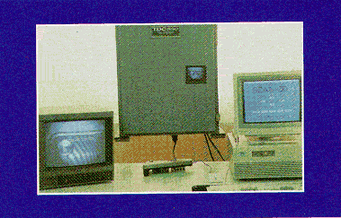

Figure 2. A typical video-based moire inspection system. The optical head (center) contains the projection system and camera. The video monitor (left) shows the moire image of a stamped metal part (lower center). The computer system (right) contains an image-processing board for fast, quantitative analysis of surface shape.
Because the moire pattern is a direct representation of changes in depth on the part surface, the video-based system doesn’t need to analyze each individual subject grating line. In this way, moire provides a degree of preprocessing within the optical system. Many optical glass-scale measuring systems in machine tools and robots use a moire pattern between two gratings, because it is much easier to see and measure a pattern of large moire lines than to resolve the deviations of a very small grating line.
Measuring with Moire Figure 3. A simple projection moire system used for making contour patterns.
Measuring with Moire Figure 4. Fringes created by overlaying two grating images.

Figure 5. Moire pattern on a soap bottle (a>, delineating areas of constant depth, and the subsequent 3-D map generated from the fringes (b).
Furthermore, by amplifying a very small displacement of a grating line, moire contouring magnifies the pattern’s sensitivity, which is the smallest change that can be seen by the optical system. The following equation is used to calculate the sensitivity per fringe, or the change in depth indicated by going from one fringe to the next:
p/[tan(i) + tan(v)]
p = the grating period on the part (the distance between subject grating lines)
i = the angle at which the projected grating pattern falls on the part
v = the viewing angle.

Measuring with Moire Figure 6. Typical fringe orientations resulting from changes in the shape or slope of the part surface.
