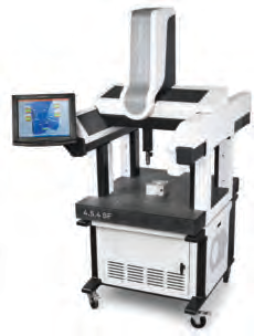

New shop floor CMMs focused on portability
Hexagon Metrology, North Kingstown, R.I., (www.hexagonmetrology.us) launched its Brown & Sharpe 4.5.4 SF, the latest generation of shop floor coordinate measuring machines. “Metrology trends are pushing dimensional inspection from the quality lab to the shop floor so inspection becomes simply another operation in the manufacturing process,” said Eric Bennett, product manager for Hexagon Metrology.
Designed for harsh manufacturing environments, the SF series focuses on portability: the new CMM measures 52.2 "×32.8 "×79.5 " and fits through a standard door. It uses standard 110/220v outlets and doesn’t require shop air. The CMM has thermal isolation and temperature-compensation elements to ensure accuracy in changing shop floor environments. The CMM’s standard elastomeric dampers isolate the measuring platform from most vibration. Inverted, high-resolution Heidenhain scales, covered ways and internal cable management protect machine components from ambient dust and debris while minimizing friction, according to the company. For extreme environments, an optional active vibration damping system is available.
The SF series comes with PC-DMIS metrology software. PC-DMIS STI+ (single touch interface) is controlled via a touch screen, expediting inspection program selection and launch. The software allows shop workers to check parts without becoming CMM experts, according to Hexagon. STI+ graphically guides users through part setup and measurement and produces reports. STI+ makes the CMM an alternative to functional gaging on the shop floor, according to the company.
