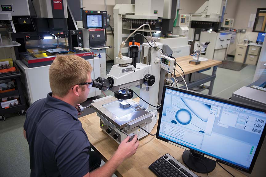

A technician inspects a mold in Accumold’s toolroom. Image courtesy of Accumold.

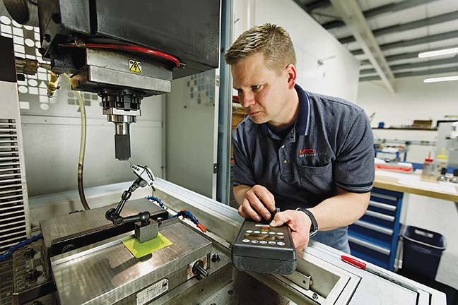

Clark explained that all MTD’s mold cavities are machined via sinker EDM to achieve the most “model-like” finished component, while the mold bases are milled, with air or high-pressure coolant applied to manage chips when roughing.

An MTD technician at corrects electrodes on a sinker EDM. Image courtesy of MTD Micro Molding.
To achieve the required tolerances on its milling machines, MTD uses laser touch-off systems because lasers can measure tool length and diameter much more accurately than a human can, Clark said. “It allows for a better blend from one tool to another, keeping the relationship from one tool to another highly accurate, which is critical in microtool building.”

Accumold’s Johnson concurred that exceeding the expected capabilities of its manufacturing equipment is essential to micro-moldmaking success. “Even some of the manufacturers say, ‘You’re getting our machines to do more than what we can do with them,’ ” he said, adding that regular machine calibration is critical to keeping them cutting
accurately.
