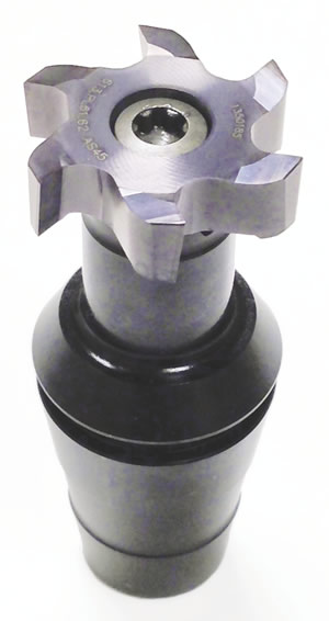

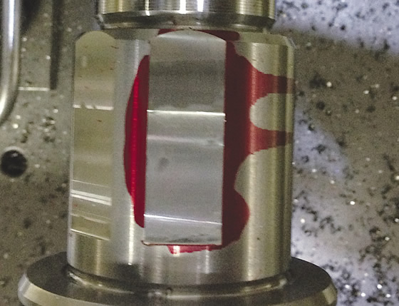

The Mini Mill tool (below) from Horn USA enables Machine Tool & Gear to achieve a 15 to 20 µin. Ra surface finish when milling flats in a steel truck shaft.

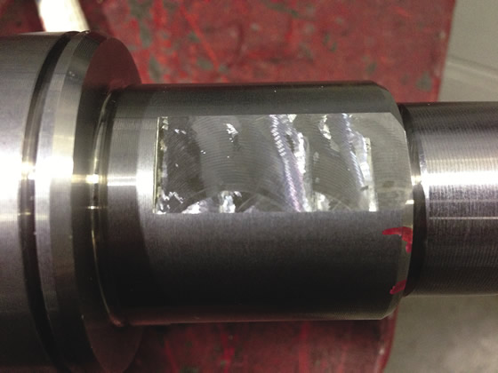

He added that the milling tool MT&G was applying is designed primarily for side milling slots and has a staggered flute arrangement that alternates between a helical twist on the flute that pulls, or lifts, a chip, and a helical twist that pushes a chip. “One flute was pushing down and the next one was pulling up and causing vibration in an unstable setup with the 90° head,” Kischnick said, noting MT&G was using a straight-shank toolholder that went into a collet.

Machine Tool & Gear was imparting unacceptable surface finishes when milling flats.
Kischnick proposed replacing the milling tool with Horn’s Mini Mill, which is designed for facemilling and has a positive axial helix on all flutes, so the cutting forces are in one direction—downward. To further enhance rigidity, the Mini Mill’s steel holder eliminates the collet. “It has the shape of an ER20 collet on the back end, and the front end is actually the endmill holder all in one piece,” he explained.
Achieving the specified surface finish of 30 µin. Ra without an additional operation between the roughing and finishing passes required minimizing cutting pressure by reducing the number of teeth in the cut from six to three and leaving only 0.002 ” (0.051mm) of material for the finishing pass. In addition, Kischnick employed a “trick” to relieve multidirectional tool pressure, which causes a tool to chatter and cut less freely. The trick is to move the tool “a few thousandths of an inch” from a flat’s sidewall during finishing.
“Any time you cut with the side and the bottom of a tool at the same time, you have opposing cutting forces against the tool: one at the bottom and one radially,” Kischnick said. “What I wanted was only to cut with the floor, or bottom, of the tool, and not have any of the sidewall hit the flutes, which makes the tool bounce.” That approach imparted a fine surface finish, he added.
After spending about 6 hours on the application, Kischnick noted the Mini Mill imparted a 15 to 20 µin. Ra surface finish. The final machining parameters are 715 sfm (217.932 m/min.) for roughing and finishing, a 0.058 ” (1.473mm) DOC for roughing and a 0.002 ” DOC for finishing, and a 0.004 ” (0.107mm) ipt for roughing and a 0.002 ” ipt for finishing. Because the previous tool could only achieve a surface finish of 80 to 100 µin. Ra, MG&T didn’t have any qualified speeds and feeds for producing the flats with that tool, he added.
